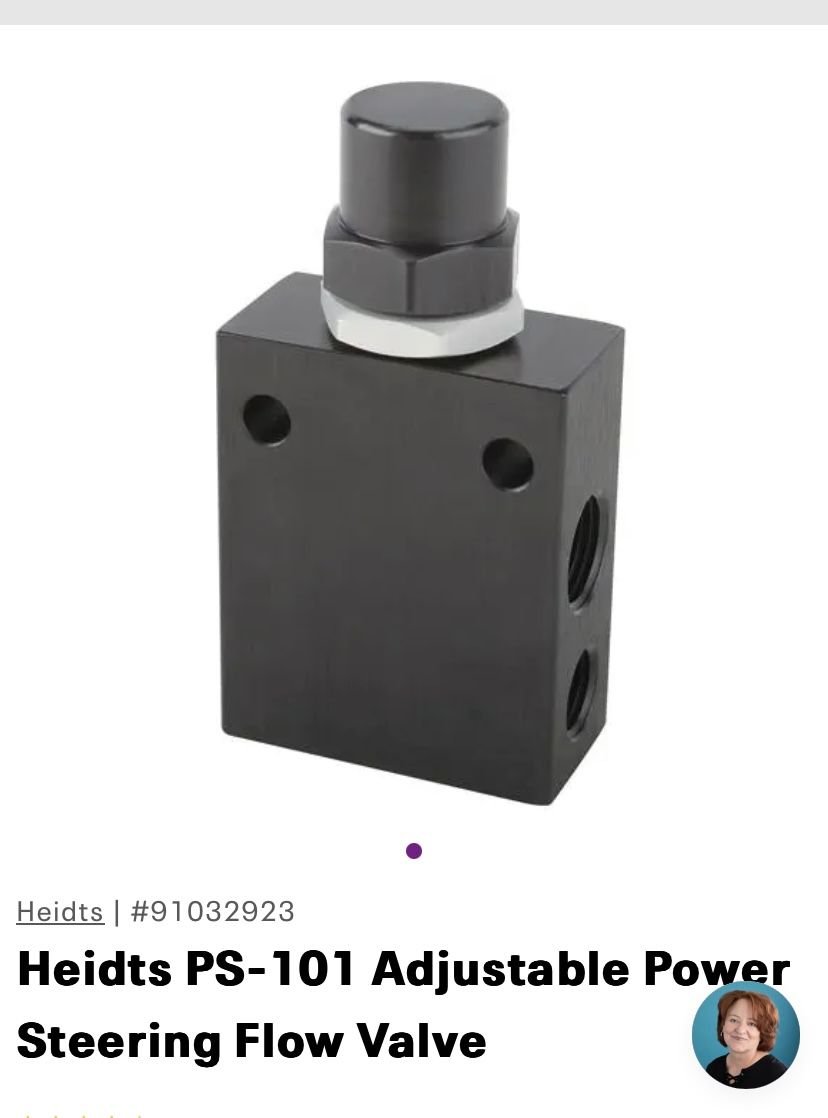

Not interested in boosting pressure at all.
I’m wanting to slightly reduce pressure by adding flow or volume. It’s the flow rate check valve you can change or modify that can add more volume and cut pressure to a degree
https://www.speedwaymotors.com/Heidt...%20(Feb28_2020)

The rabbit hole continues. I called Turn One today. They are super nice people. Word is that Heidt adjustable valve is more for pressure than flow. Turn One tech said it can actually make high assist maneuvers tougher. Another issue is the GM rack controlled by Magnasteer. It can overide the force of input and reduce the flow rate the pump makes. They also suggested I try a GM built PS pump valve that will flow a higher rate of 3.0 instead of the OE 2.5. That's my next line of attack. Flushing the PS fluid again and swapping out the flow valve
