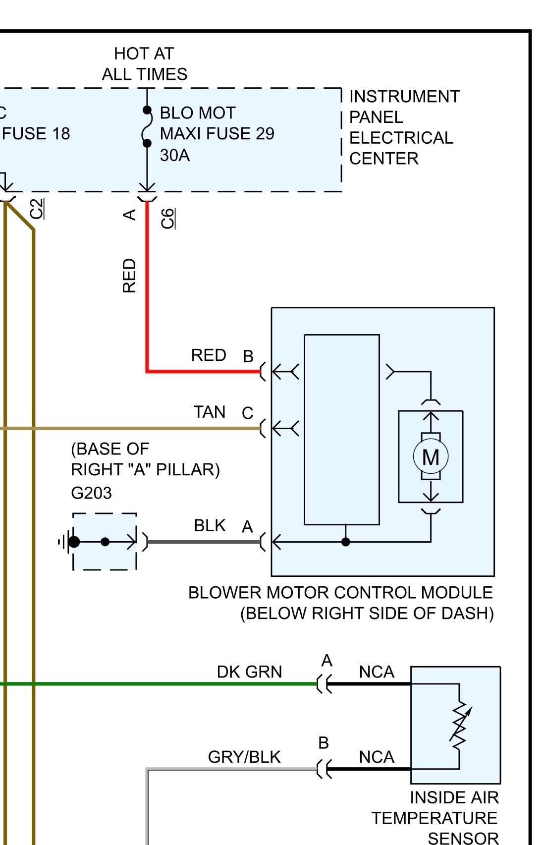

I looked at several posts about this, I checked all the fuses (i think) ITS NEVER A FUSE !!!!
The entire system is very new, i just drive the car on "windows down kind of days"
I am doing a double din set up and had the controls sent out to have lighting upgrade re installed everything lit up and was very pleased..
Today however i was out and a crazy South Florida storm popped up and much to my surprise it failed to come on..
I am trying to avoid the motor removal and other things I have seen on other posts..
My question being could the control panel have been compromised ? It has a warranty, I think it would be a big coincidence for that not to be the problem..
It all lights up fan speed bars go up and down, temp, etc. just no air
Duel zone..
Thank you in advance for any input .....

What year is your car ??…it can be the wiring, HVAC module (TAN “control” wire from HVAC module), blower control module, or blower motor itself…you can remove the motor and apply 12 volts and a ground to it and see if it runs…if you’re not far from me in Cape Coral I’d be happy to look at it for you…wiring is for a ‘99.
