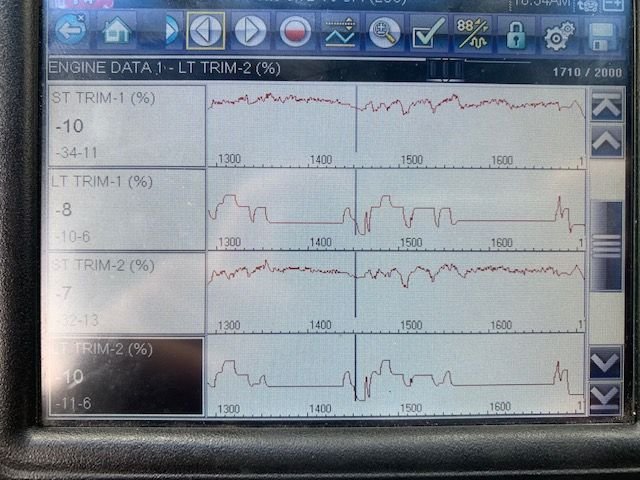

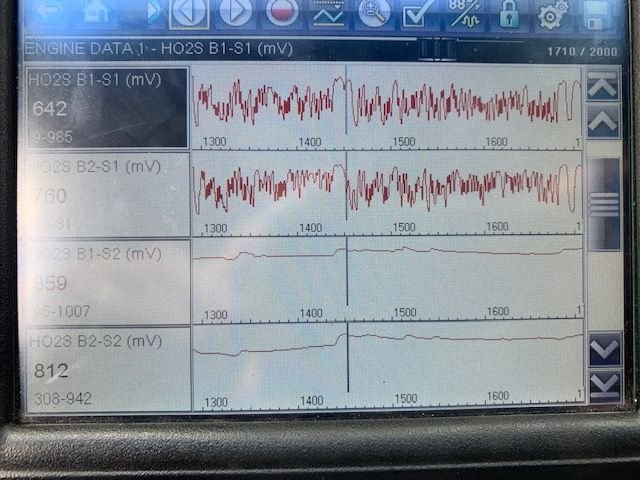

I was able to snag some pictures of the scan tool readings but wasn't going to post them as I wanted to actually set it up right to make it easier for everyone to read the next time I had the tool and take more pictures then. I'm stumped and just want to give as much info as I can... (I apologize for the glare and not setting this up right but when I get back to the scan tool I will set it up to more frames/sec and give proper voltage range references+better idle frames) Not very clear markings so I will do my best to describe what happens when- The dark line represents a stop at a stop sign so I'll start there. Shifts occurring at 1470, 1490, 1510, and 1570- each time I brought it up to roughly 3000rpms, maybe a bit less in the later gears. after 1570 is cruising speed for a while(2000ish rpms 5th gear). I should have let this go on for longer- at 1680 you can see I come to a stop and it begins to idle again. Looking at it now I'm realizing just how bunched up the o2 readings are under load, height-wise and width-wise, then it returns to normal 200-800mv oscillations at idle. Between 1570 and 1600 I do not think the sensors got out of the 400-500mv range... You can see my ft's lean out as I accelerate and then drop back down a bit when coasting. I think cleaning the intake system, MAF, and all of the other tests/cleaning/torquing I have done have made the trims a little less rich overall, obviously not seeing the -20's as before but this was also a short drive with temps in the desired range (mid-high 190's) but still feeling the drag...

Fuel trims should not lean out as you accelerate...if they do it's either a fuel delivery or MAF issue...I do a VE or volumetric efficiency test when faced with this possible issue...I use a separate specialized scan tool that can tell me if the engine is breathing properly and I'll know just going a block...if you give me some numbers and let me know what the max MAF is in grams/second and RPM as you hit WOT I can plug the number into my calculator...these are the numbers I need:

To C5 Zo6 Running Rich
