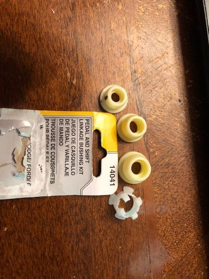

Probably the transmission cable bushing. If it's the one on the transmission, the bushing can be had at any auto parts store. Manufacturer is Dorman. Any decent mobile mechanic can handle this. IF however it's the bushing at the shifter then it's a bit more involved. It's the one with the black mark. Happened to me in my C6 3 years ago.....stuck in park.

I believe they are but in that pic of the bushings I posted, the one I marked with a black stripe is what you need for the rear. Be forewarned though, it's a biatch to get to.....
