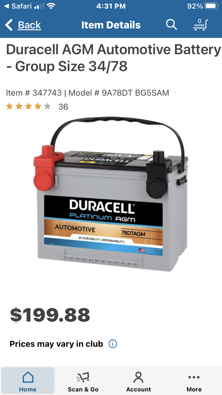

Got the date wrong May 5-7th, pic as of request:
