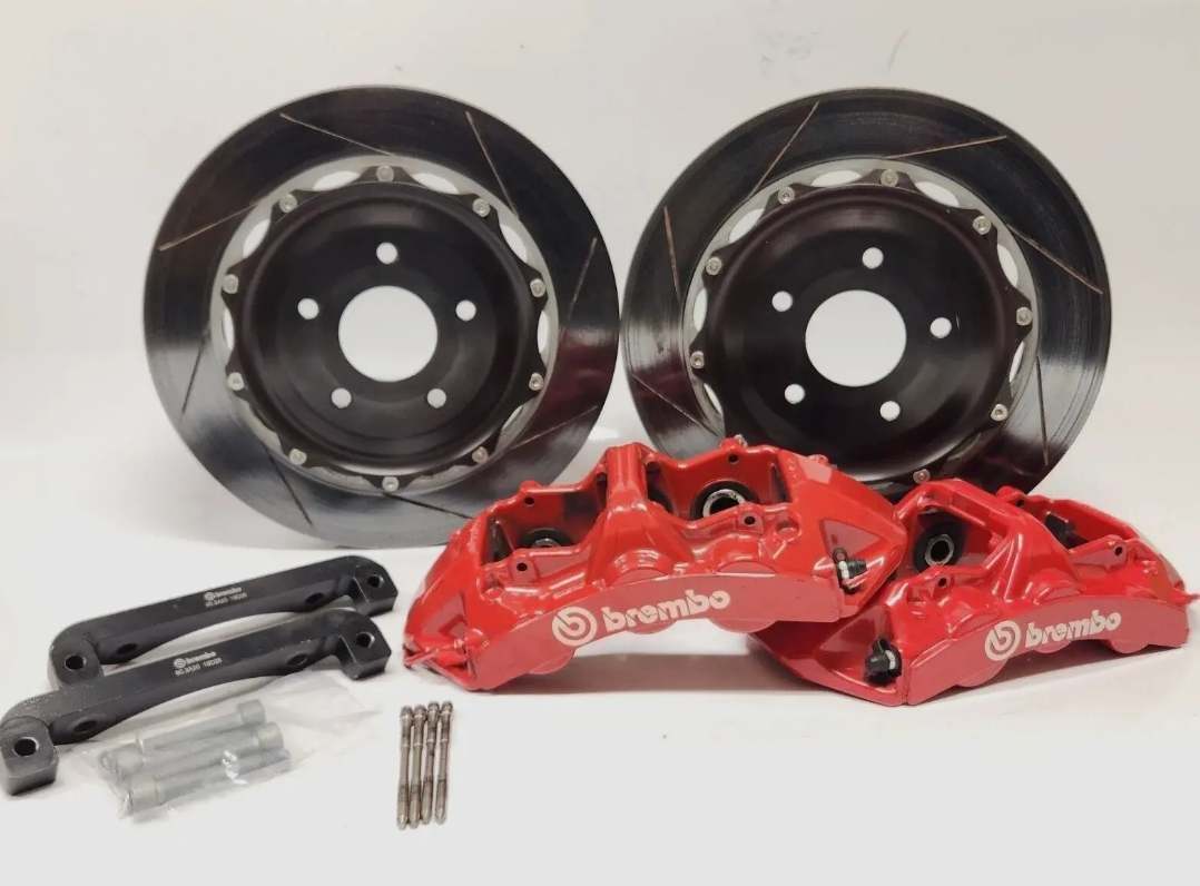

I scored a pair of used front Brembo Monoblocks and 2 piece rotors (Brembo p/n 1M2.8013A2) for my C5 Z06.
Looks like they do not come with pads.
Hawk makes pads for the calipers (as does EBC and of course Brembo).
For street performance use and the occasional track day can anyone recommend Hawk pads and if so, which one?
Not worried about dust or noise. Full Billy Boat exhaust so the car is already quite noisy.
Thanks.
Joe
