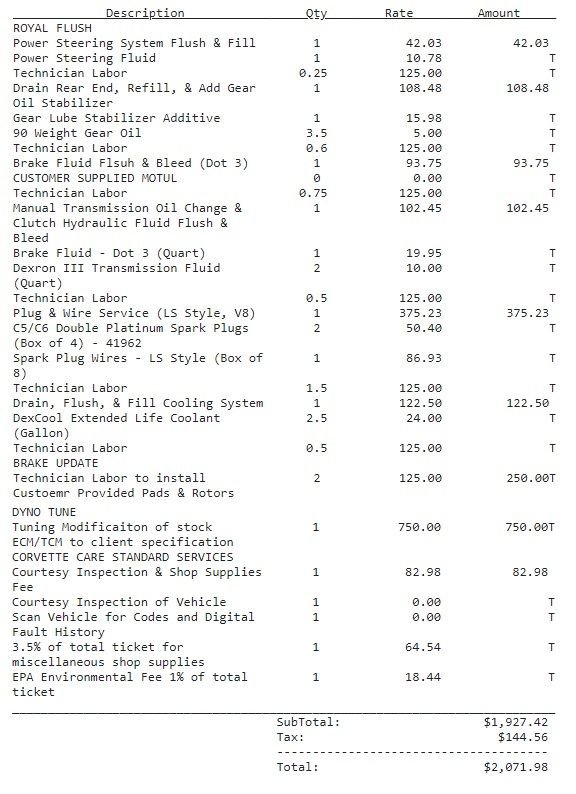

Found this on C5 general , Includes new plugs, wiring ($515+?) a tune ($750). customer provided brake parts, some fluids.
Great Inputs here on C5 general and C5 tech. For sure items-Flush of coolant, brake fluid, power steering. Belts and hoses will be thoroughly checked (Do I need to c/o regardless?)
