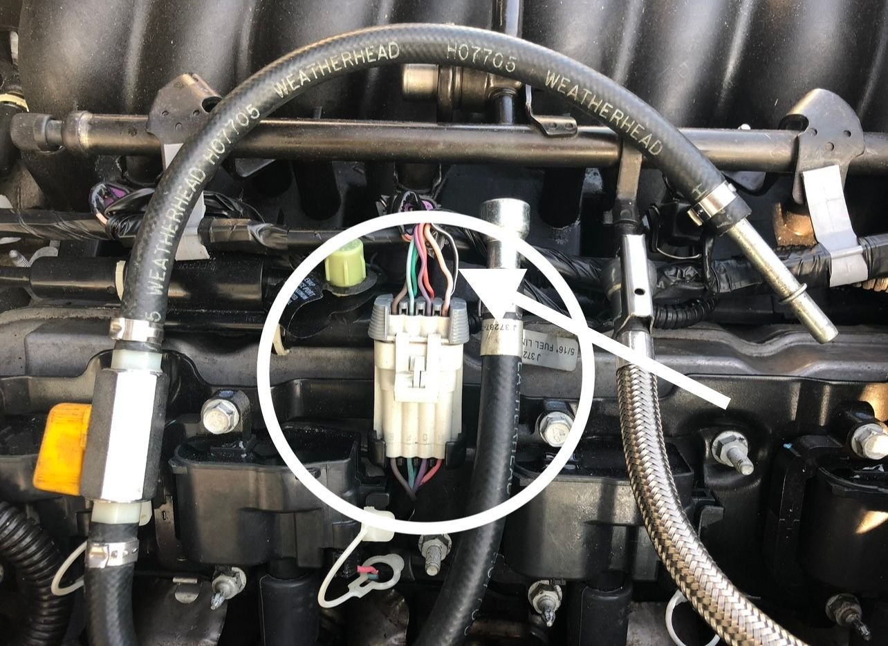

The 2 wires behind the left cylinder head are the grounds for each bank coil packs…if there was a broken wire on one of those 2 ground wires 4 coil packs on that particular bank would not work…I doubt that is your issue but if you look at the white connector the black/white wire (arrow) goes to the back of the cylinder head…if you think that is your issue connect a 12 volt test light to battery positive and back probe that black/white wire or disconnect it and front probe it…if the test light illuminates the ground is fine.
