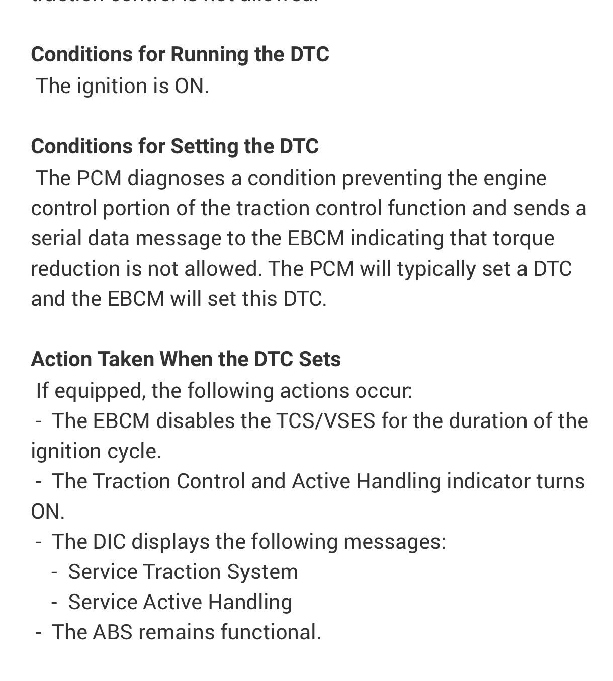

Old May 13, 2023 | 10:30 AM
C5 Diag's Avatar
C5 Diag
Moderator, Tech Contributor
Posts: 15,600
Likes: 4,059
From: Cape Coral, Florida
The 1278 is more of a “nuisance” code than anything…I see that DTC a lot on many C5’s I hook a scan tool up to…it will not cause a TPS code or cause the car to go into limp mode…the code info below so you can read what causes the code to set and what the car does when it sets…since you have a scan tool with the key ON look at TPS 1 and 2 voltages in live data..make sure that TPS1 and 2 voltages don’t drop out when pressing the accelerator slowly.
