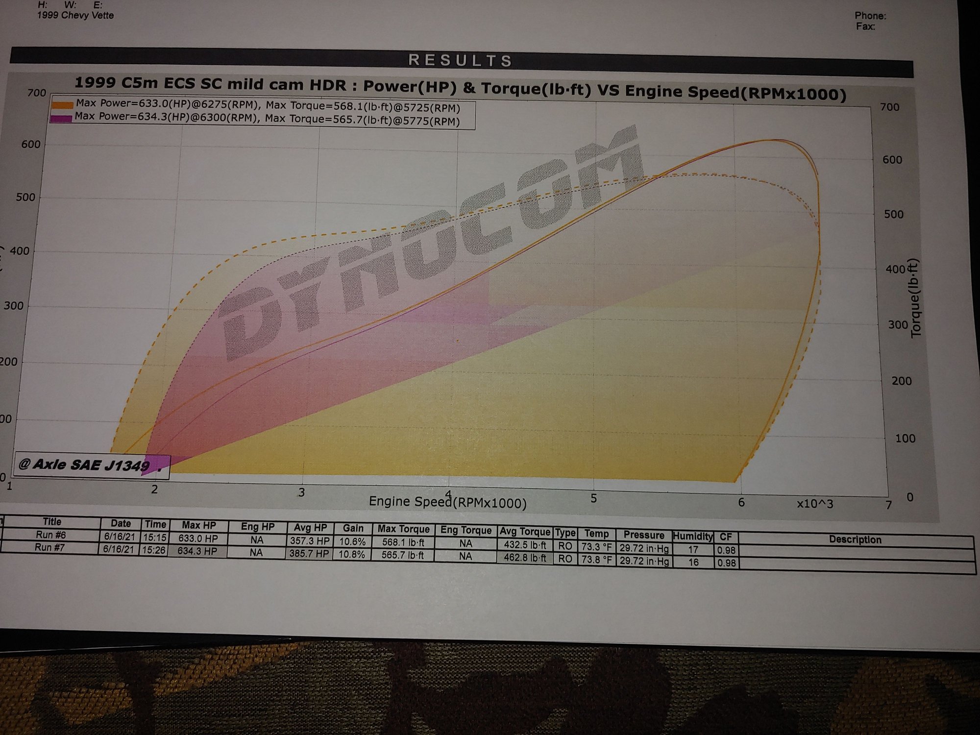

With a cam that makes similar power to your 228R (I ran the 228r prior to my 232/236/113- and NA power and curves were similar) 1 7/8 long tubes, BTR 660 springs, ported 241s and the Novi 1500 kit from ECS (on 93 pump @ 10psi):
After the tune I needed to opt for an elecric water pump from Meziere. The belt ripped my bell off the manual pump on my maiden voyage driving it home.
Added another $1k to my cost. Kit was $6,199 with tune.
Car drives like stock all day if you want it to. Very wife/girfriend friendly until you decide it's more about you enjoying the ride than she.
