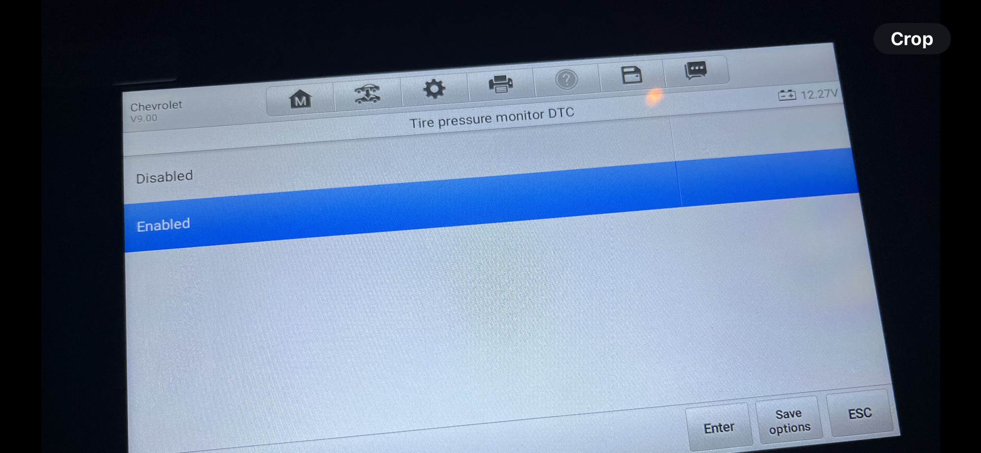

Sorry to bump this, I couldn’t find my answer searching.
Will the Autel MK808S allow me to turn on TPMS functionality for my ‘04 C5Z? I would like to add TPMS ability since the car came from the factory with this turned off. If not, I can have the dealer do it with a Tech2.

As far as I know (had to do this on my 02 Z), You will need the GM TECH2 to communicate with the BCM to accomplish this procedure. All of the TPMS functions are in the BCM.
. I've herd stories of dealers refusing to do it because of liability concerns. You should be able to find another Corvette C5 person in your area that will help you with use of their TECH2. IF YOU LIVED CLOSE TO ME, IDE LEND YOU A HAND and program it in to your BCM.
If you take the procedure to a dealer, they MAY do it for you. Be prepared to pay at a minimum, 1 hour labor!!
Like I stated, I personally would look for a friend with a TECH2 close by who is willing to help. Where do you live?
Maybe C5Diag can discuss if the scanners that he has and have had can communicate with the BCM Functions.

The Autel MK808S did end up working to activate the TPMS functionality on my ‘04 C5Z. It didn’t work at first so I just repeated the procedure 10x and it took. Thankfully I don’t have to pay $200+ at a dealer for this.
