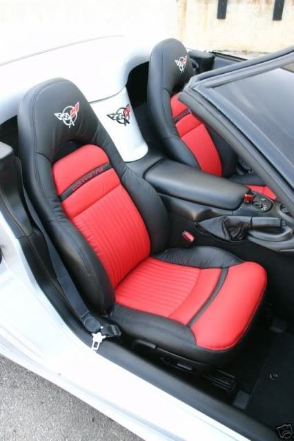

As a Vette Veteran like yourself (and I assume 40-60+ year old?), what is your opinion on my cars looks? I may sell it next summer and I am curious how people are going to like it, I know the younger people will love it and I feel most older people would like it with only a very select few purests etc that don't like it/the mods.
What's your opinion?
(The interior pic isn't my car its just the same seats as I don't have a pic of my interior, and I maxed out the rear on the stock lowering bolts so the fitment is proper now and I got the USA flag emblems)

I could give you my opinions but it would be just nit picking about what I prefer.
Your car doesn't look bad at all and is pretty common amongst this generation.
