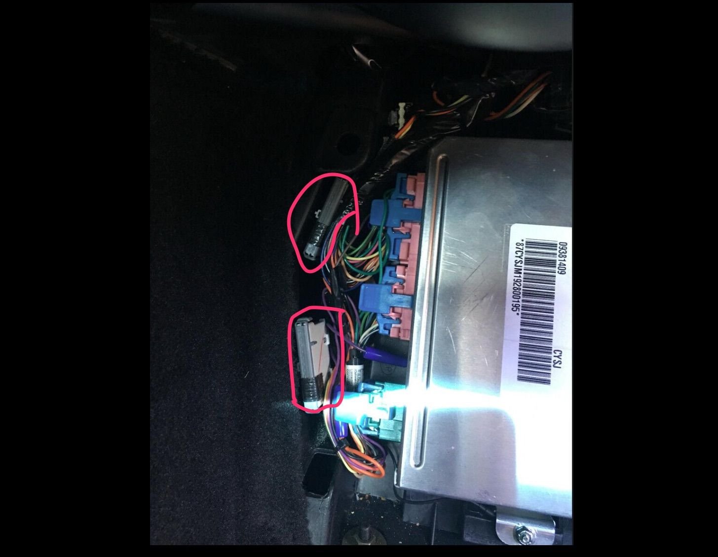

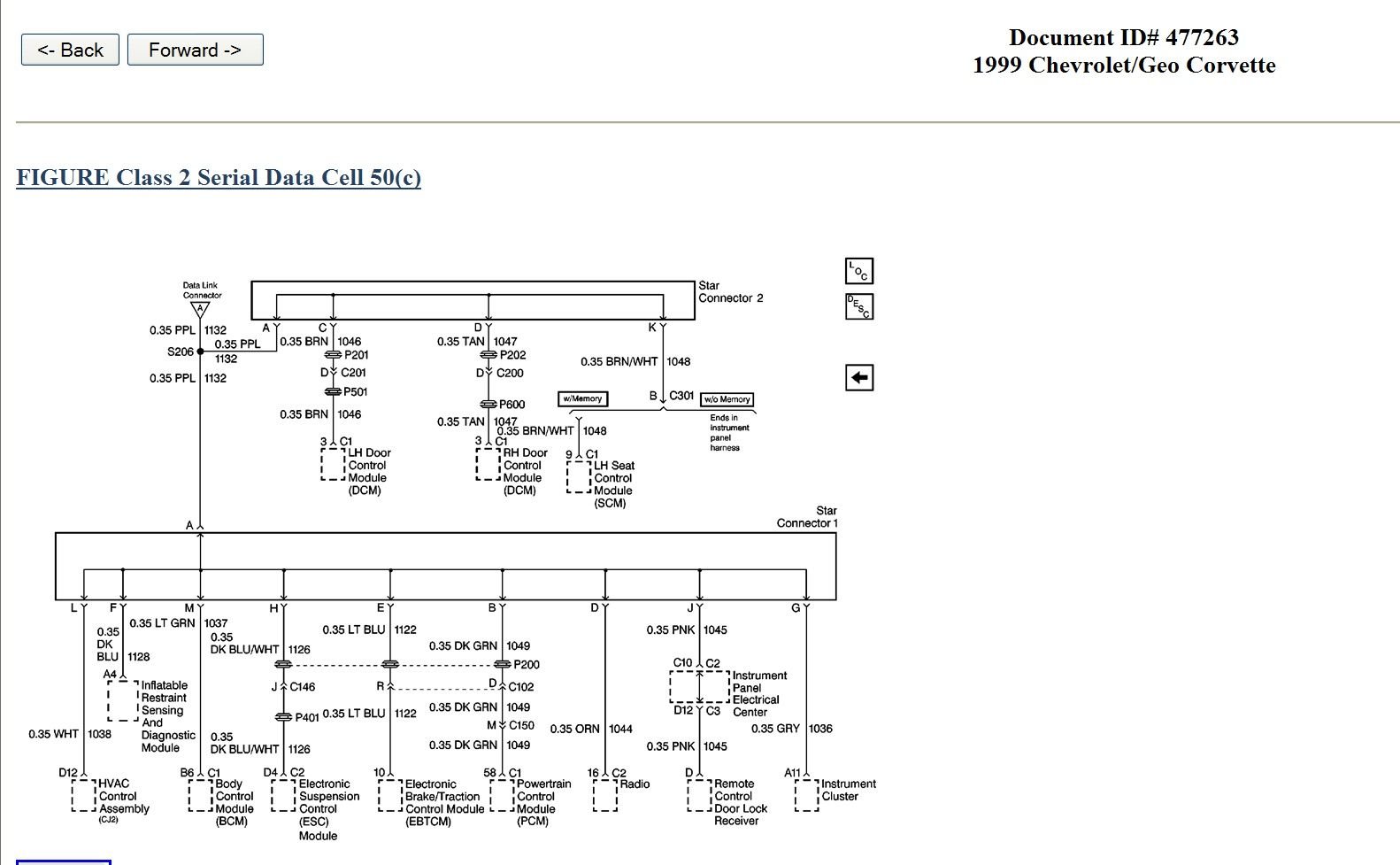

Here is the schematic of the star connectors on the serial databus and the locations of them on the left side of the body control module in passenger footwell
Awesome thank you so much for that! I have to go out of town today but as soon as I get back I will get busy. I really appreciate it
