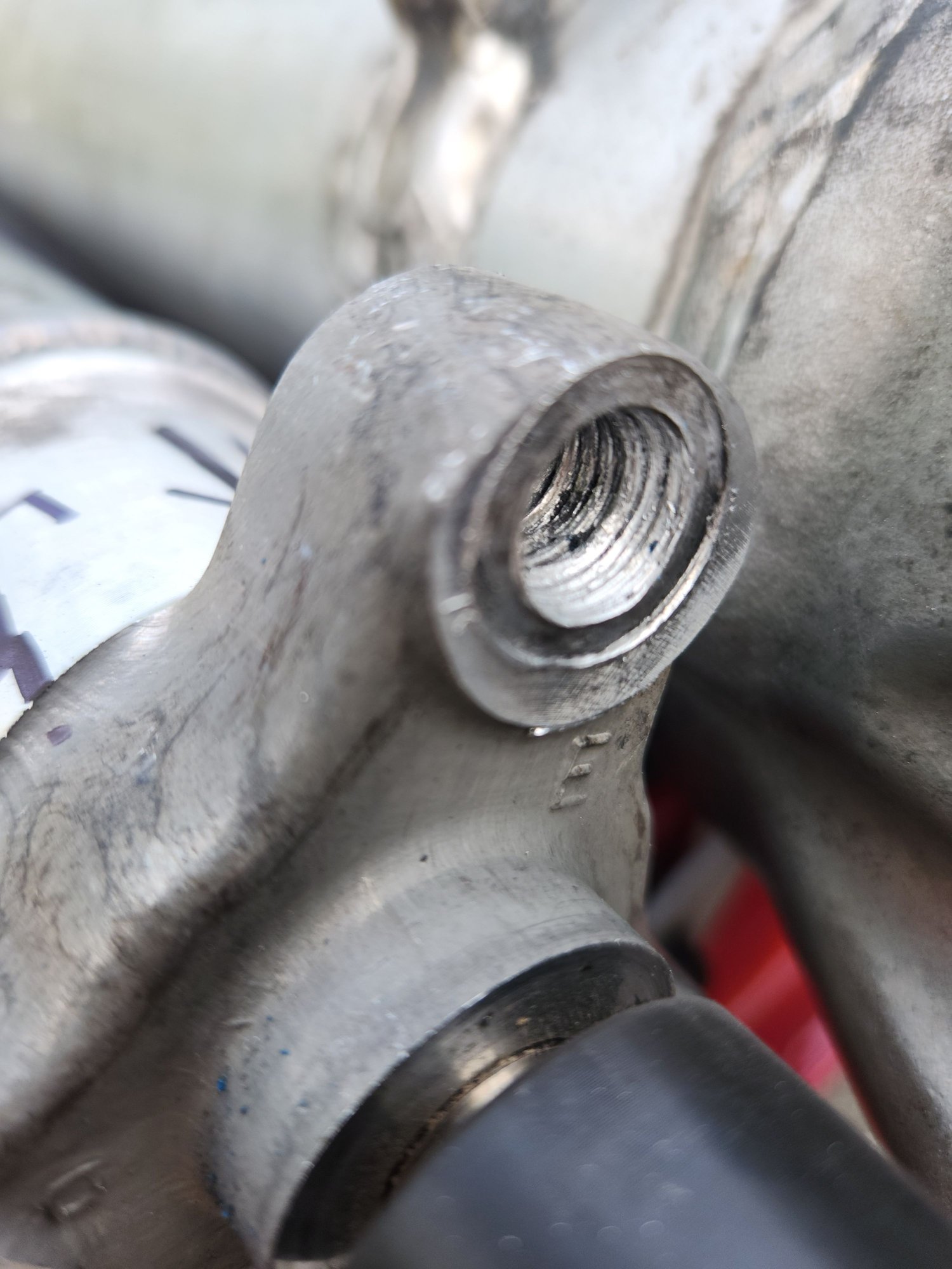

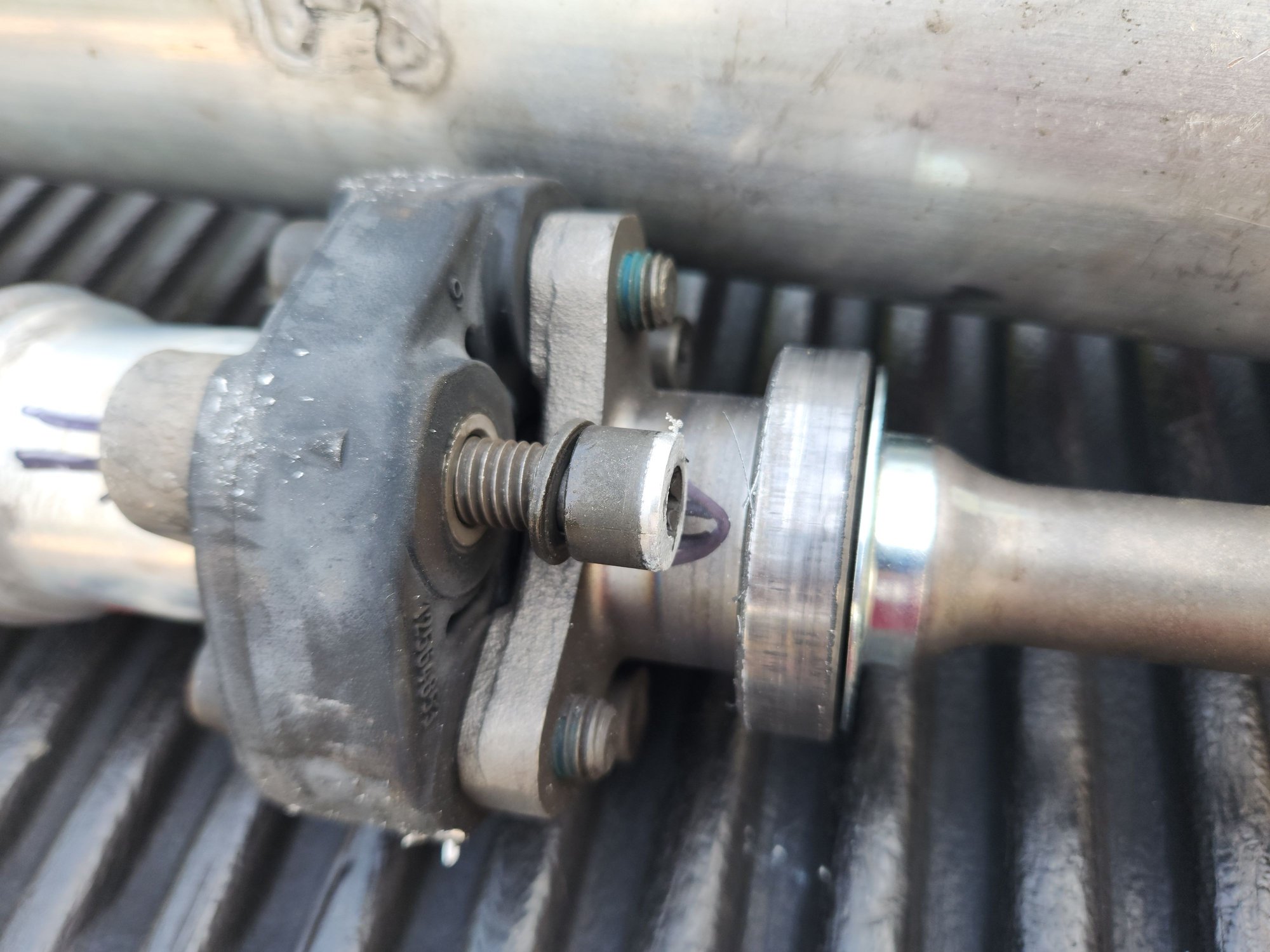

Turns out the issue is one of the 12mm bolts backed out of the DS and was flailing around. The threads in the DS are effed up so it's done. There's a magic marker scribble on the DS pointing to the front bearing indicating it was replaced Mar 2022.
I bought the car end of summer last year, and I'm still sorting out who did what to it and who worked on the TT. The guy I bought it off bought the trans from another guy freshly rebuilt by RKT in MD (after he blew up 3rd gear in the original trans) and the diff was then rebuilt by RKT and the pinion opend up to accept the 30 spline output shaft in the built T56. He doesn't remember what was done to the TT.
The couplers look fine, maybe they were replaced then and the bolts not properly tightened... I bought a TT assembly with 55k miles on it from Contemporary Corvettes in Bristol PA today (good place to deal with, got my 70k miles 97 LS1 for my 69 Camaro vert for $3200 a few months back) and I broke two t50 torx bits trying to disassemble that DS and I still have 5 of the 12 bolts to remove. No friggin way a factory installed bolt fell out. I'm replacing the couplers with new AC Delco units (Rock Auto $144 each the best price I could find and in stock) and the bearings with Timkens.
