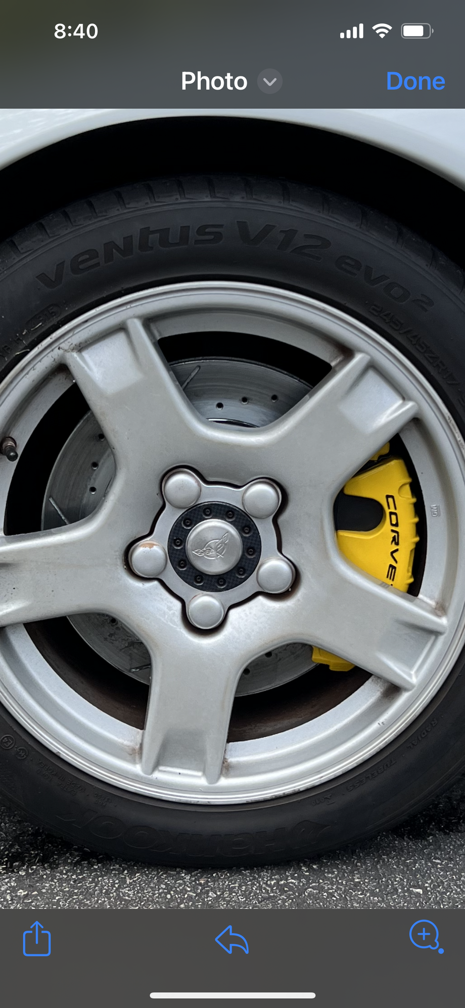

Vader , you can’t go wrong with TPS Motorsports , I just installed mine and they were great to work with👍…now time to save money for wheels 😏
