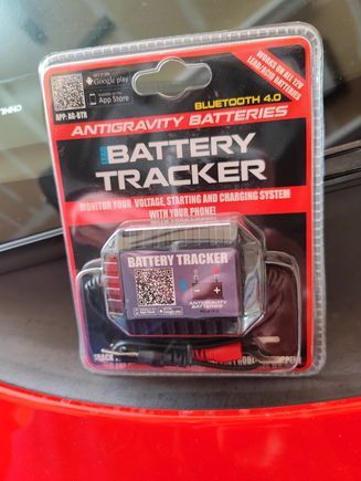

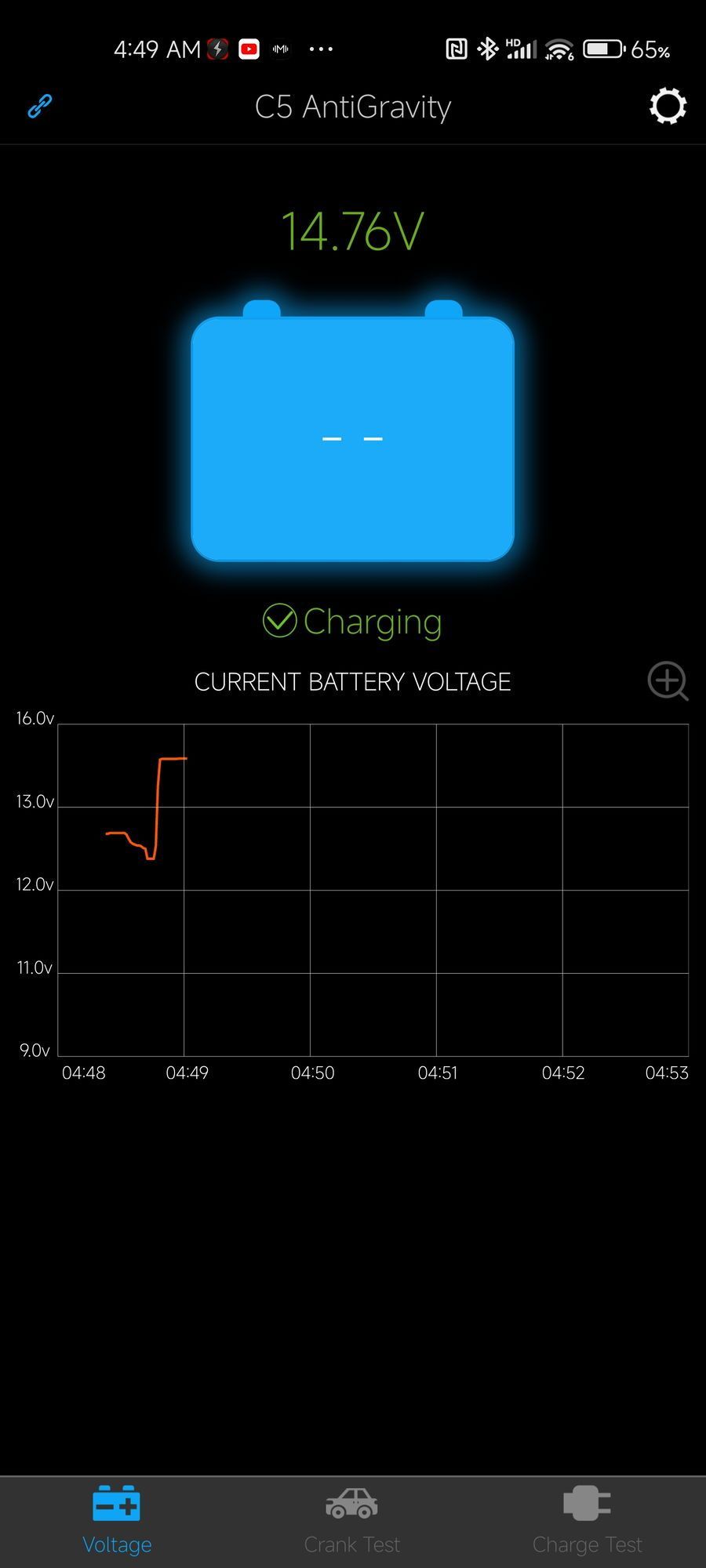

I use this doohickey to monitor my battery in real time. They have their own app...great way to keep tabs on your battery condition
https://antigravitybatteries.com/pro...ker-lead-acid/
