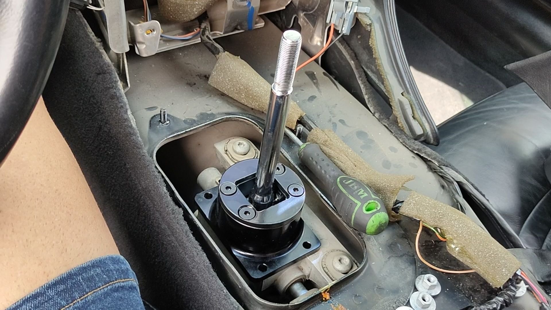

Received it yesterday and installed it today. No way this piece of ***** could do that much on the way how you enjoy the car! Man... Now we're talking!! Feels hard...very hard when changing gears but I definitely LOVE IT! Now it's a car for men... Arrived home today feeling my arm pumped lol this is the most cheap mod everyone MUST do.
Being a Chinese thing I preferred to see how was made and unbolted the top bolts to see how was made. 1st) two out of four top bolts were losen. 2) no lubrication at all inside, not even in the plastic ball joint. So I took advantage of my curiosity and added some fine grease to the moving parts inside of it. Also added a very small washer I found (1mm height) to eliminate a slight play in between the bottom sfere and the bushing + some more grease.
Greatly happy with the result.
