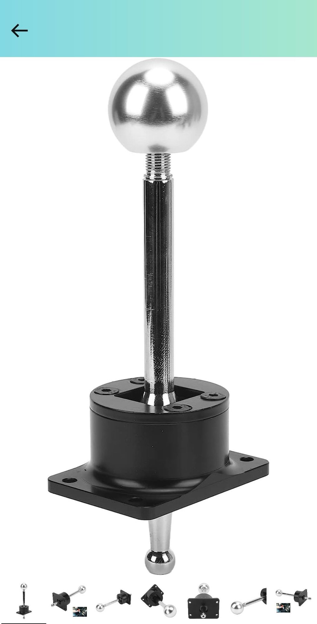

Hi everybody.
Found this short shift on Amazon. Some other Chinese vendors sells the same/identical product.
Does anyone know of is this any good? It's pretty cheap on price...about 60-80 bucks:

I have a similar one. It was ~$50. I wanted to try one out before I spent the $$ on a more expensive unit. It was actually pretty nice. The machine work on it was nice. It did also shortened up the shifts. The only downside to it I did not like was that it has some axial rotation. It was probably a couple of degrees. Not a whole bunch but its there.

I ran the similar design high quality TMOD Customs shifter for a short while — with no isolator on the shift shaft, I found the shifter howled more than a little as I accelerated. I would anticipate this one to make a lot of noise.

I've been running this for a couple years now. It did have axial Play that was mentioned here in the thread. I tightened it up with some thin metal tubing and lubed it up. I enjoy the shifter. Definitely more effort to ****. I used a weighted shift know and is much nicer feeling.

Unfortunately I don't have any good photos, but if you take the 4 allen head screws and remove the top plate you will see a couple springs and a shaft that pushes against them. The base is machined slightly larger, you will feel and see that play, like if you took the shift **** and turn it like you would open a jar. It's small but annoying to some. I just happened to have the perfect diameter of some of steel fuel line and cut small pieces and use it like a sleeve to take up the gap. You would have to measure your own and try to find some. I also needed to adjust the preload on the springs to get it to feel perfect for the left to right motion, but I think I have seen that on name brand shifters. For me, this is perfect, feels like a gated shifter. The weighted **** doesn't make it easier to shift, just softens the feel. Amazon had these for like 30 bucks. 400g ball.
If your handy and willing to make it just right, its worth $50.

Is it just me or is the pivot ball missing?
