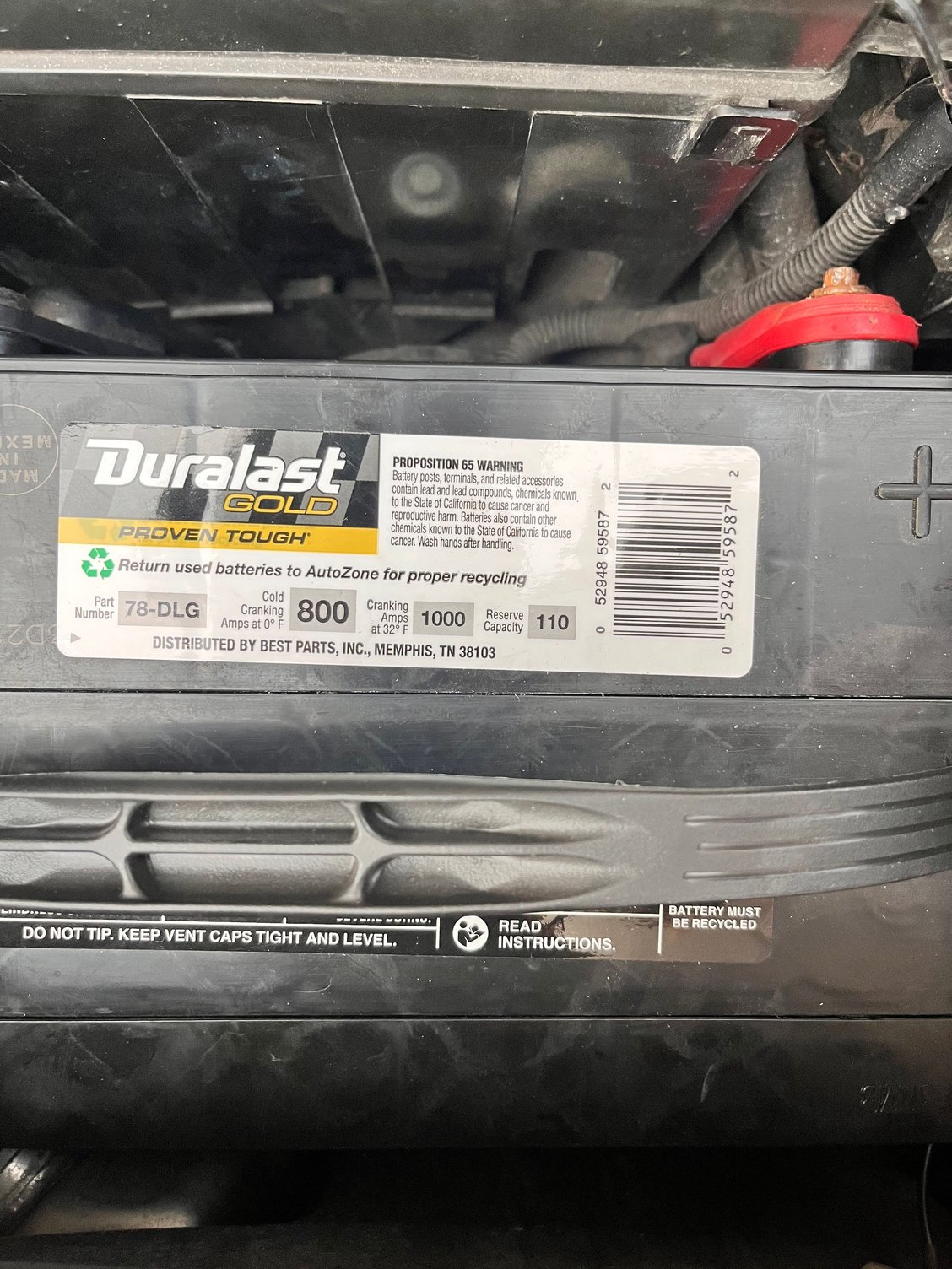

hey, i have a 1999 c5 corvette. to keep the story short my battery died on me and it wasn't turning on my car the gauge cluster wouldn't turn on the gauge needles wouldn't even move and when I tried turning it on I got a "low voltage" on my car as well so I took the battery out and went to my nearest AutoZone as they have a battery tester and it said it was dead so I tried to get a new battery the same one that was previously in my car as the previous owner added that battery and I never had issues with it but they didn't have the same one so they gave me something else that was" similar" ill attach a picture below but its not working it barley turns the car on I still get " low voltage" and "reduced engine power" if the car does turn on but not without struggling

That battery is adequate for operating your car. Did you fully charge it? They often have been sitting for a while at the parts store.
My wife's start/stop feature still didn't work with a brand new Optima Yellow top until I left it on the charger overnight.

Did they charge the battery and did they do the installation or did you? The battery — fully charged — should be more than adequate for the car. If you have a volt meter, see what the voltage reads at the battery terminals.
I’ve found on my’99 that every battery disconnect and reconnect results in something I don’t anticipate. More than once I’ve done it twice to clear an issue.
