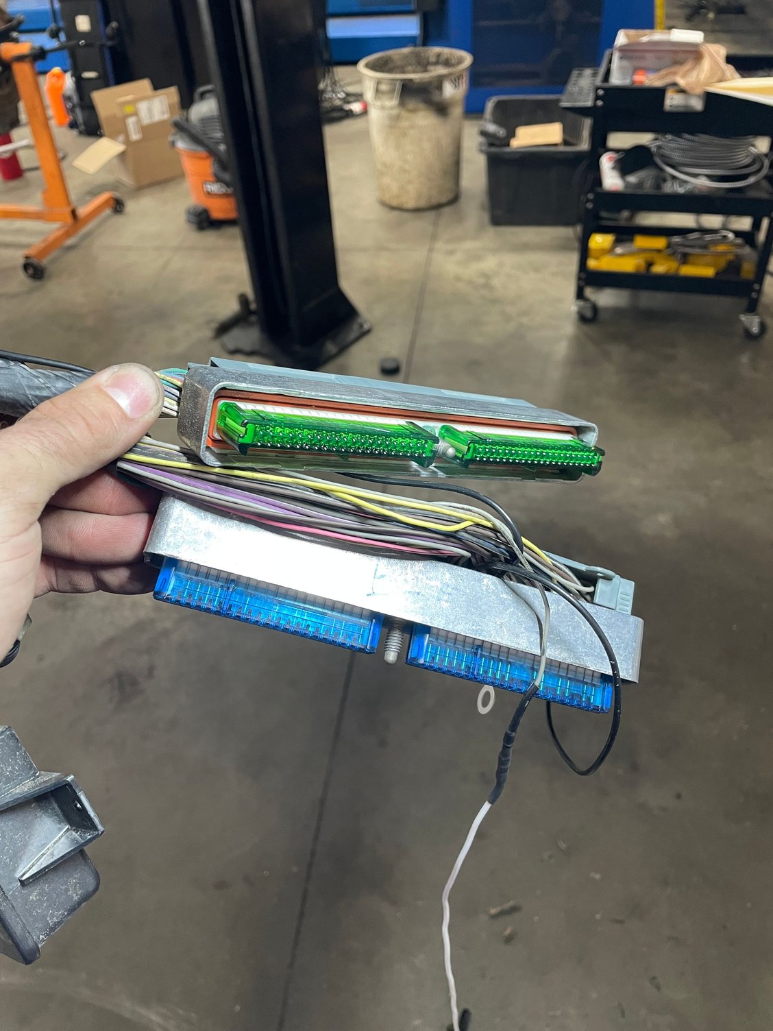

-Early C5 PCM is known as a P01 version. You need to source a P59 from later C5's or other LS variants. Service #: 12586243 Hardware #: 12583659

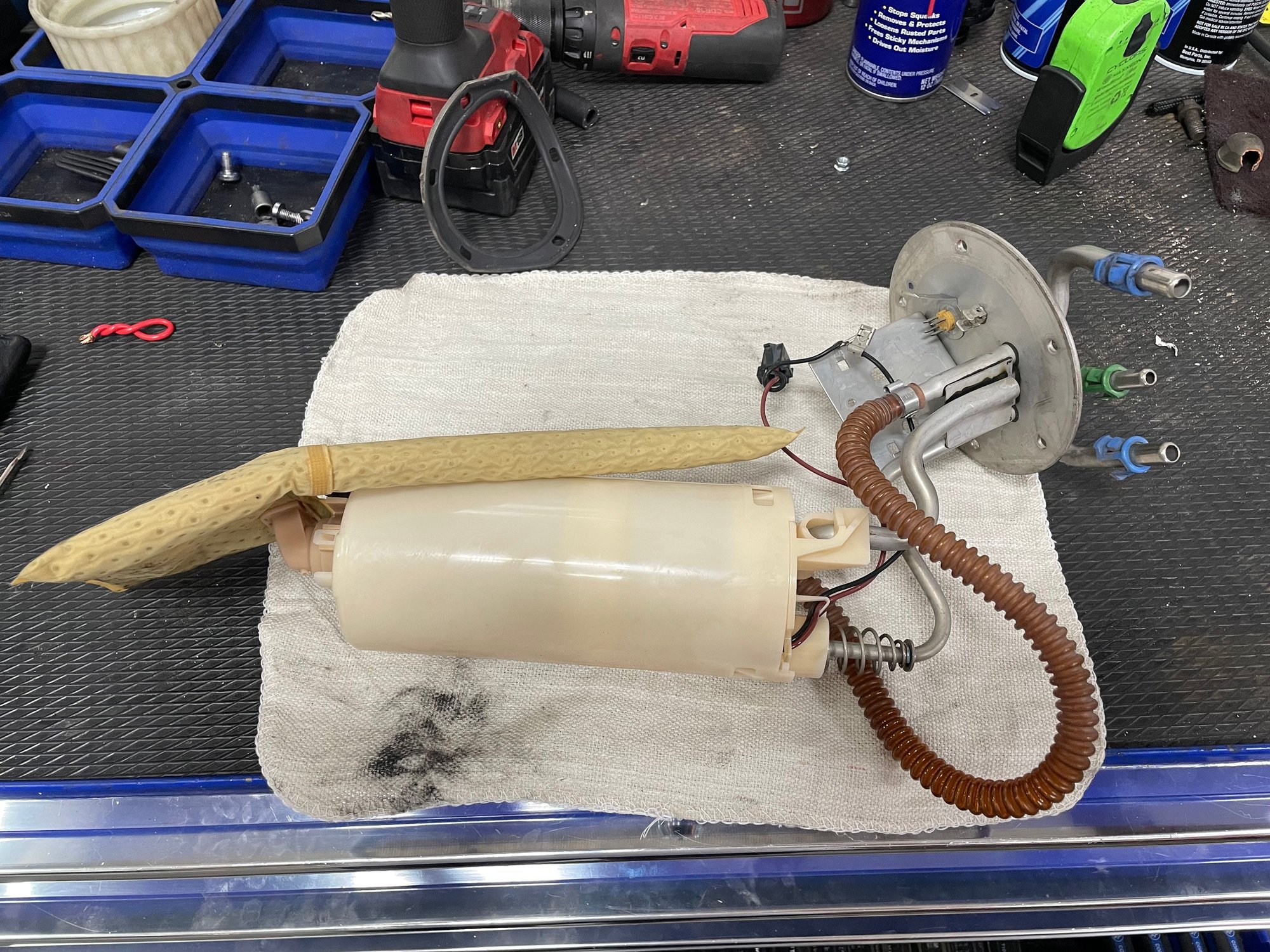

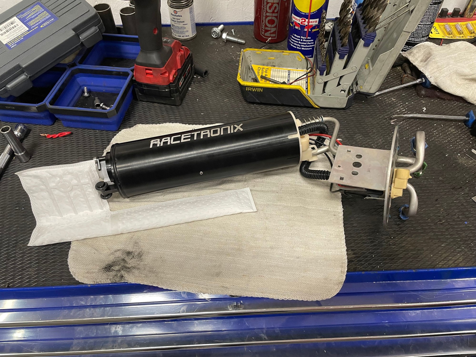

-Racetronix RFPK-055-340 fuel pump kit. Comes with everything you need including a billit pump bucket, just have to swap the fuel hat over and do some wiring. Other pumps work as well, just source one up to the task.
-Racetronix FPWH-007 hotwire kit for above pump kit

-PCM Green terminal covers I sourced used from Ebay. P01 PCM is a Red/Blue connectors and we are going to a Green/Blue combination.

Wiring:

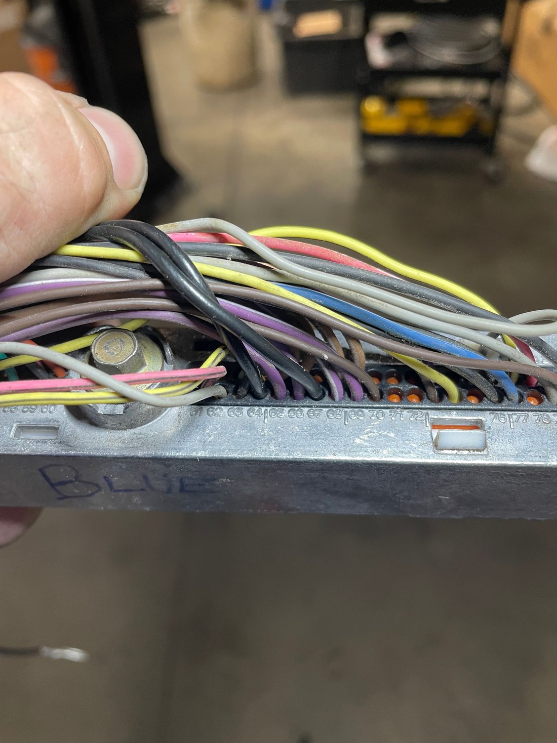

-Blue connector: two grounds were added at pins 64/67. These were grounded to the frame above the PCM via standard ring terminals and self-tapper screw.
-Blue Connector: added sensor signal wire to Pin 56

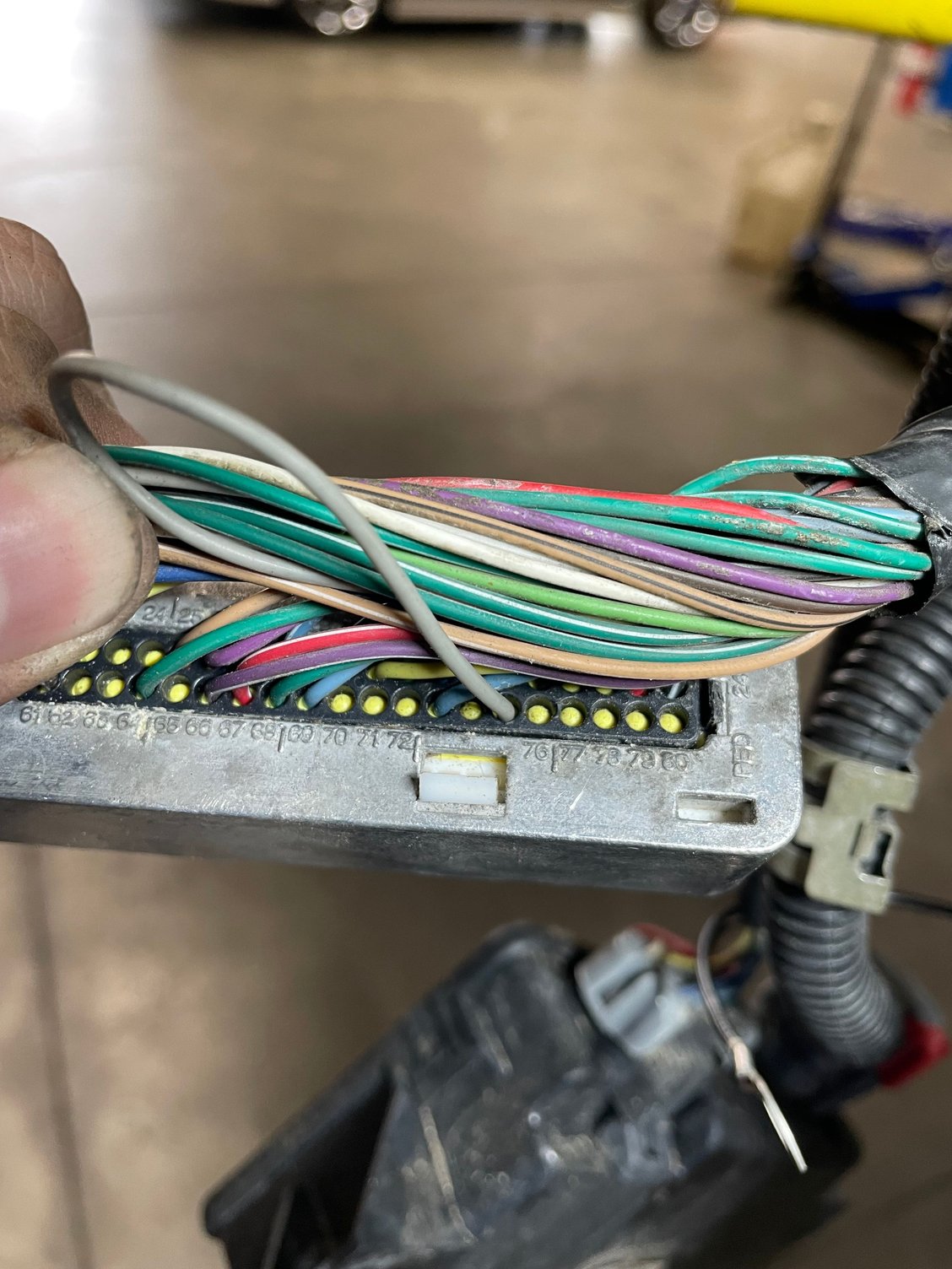

-Green connector: Pin 52 (grey wire) moved to Pin 75
-You will also need to ground E85 sensor and power it to a switched 12V source both of your choosing. Sensor ground also tied into above PCM ground location.

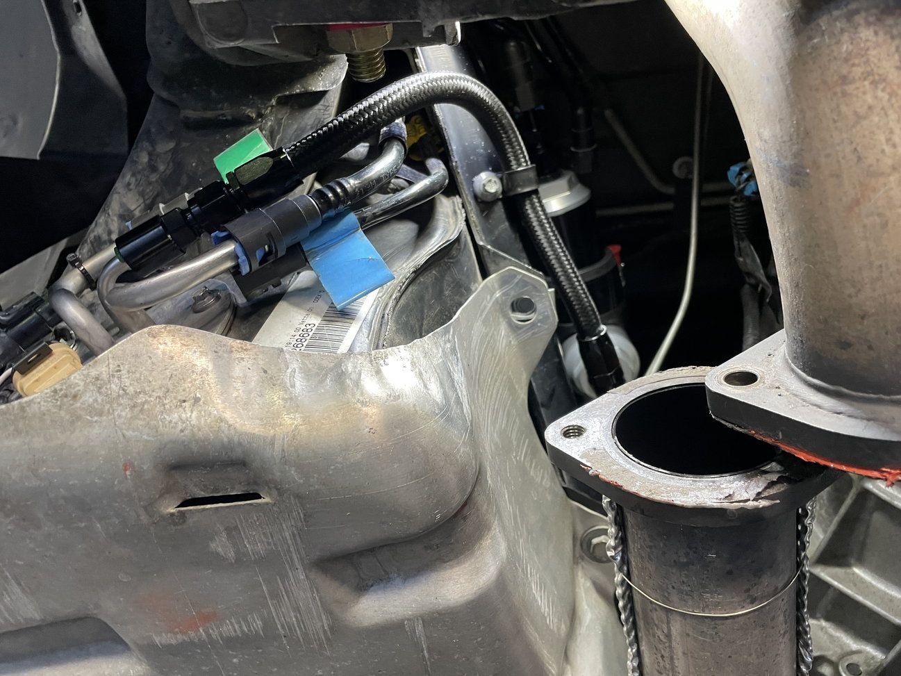

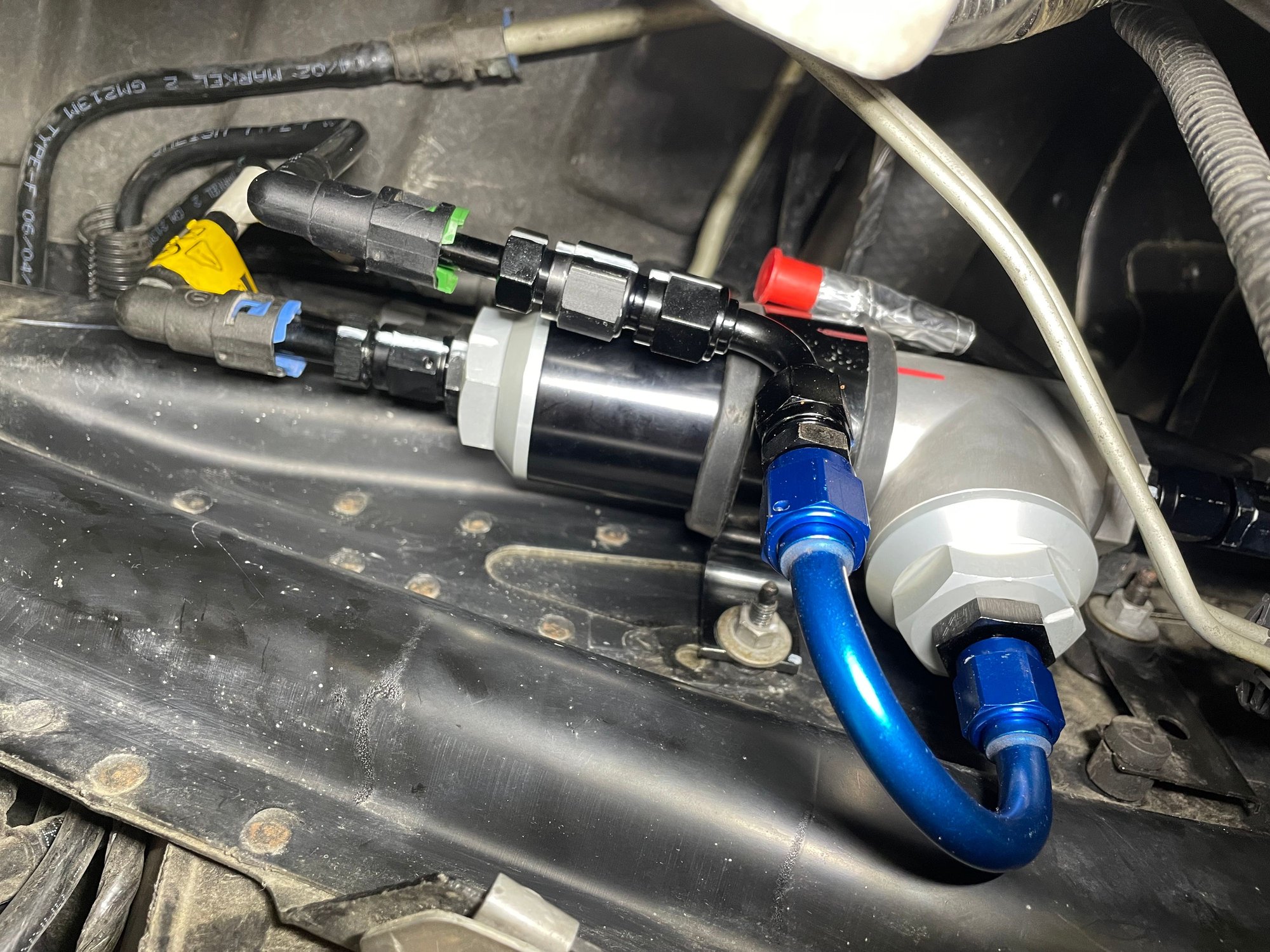

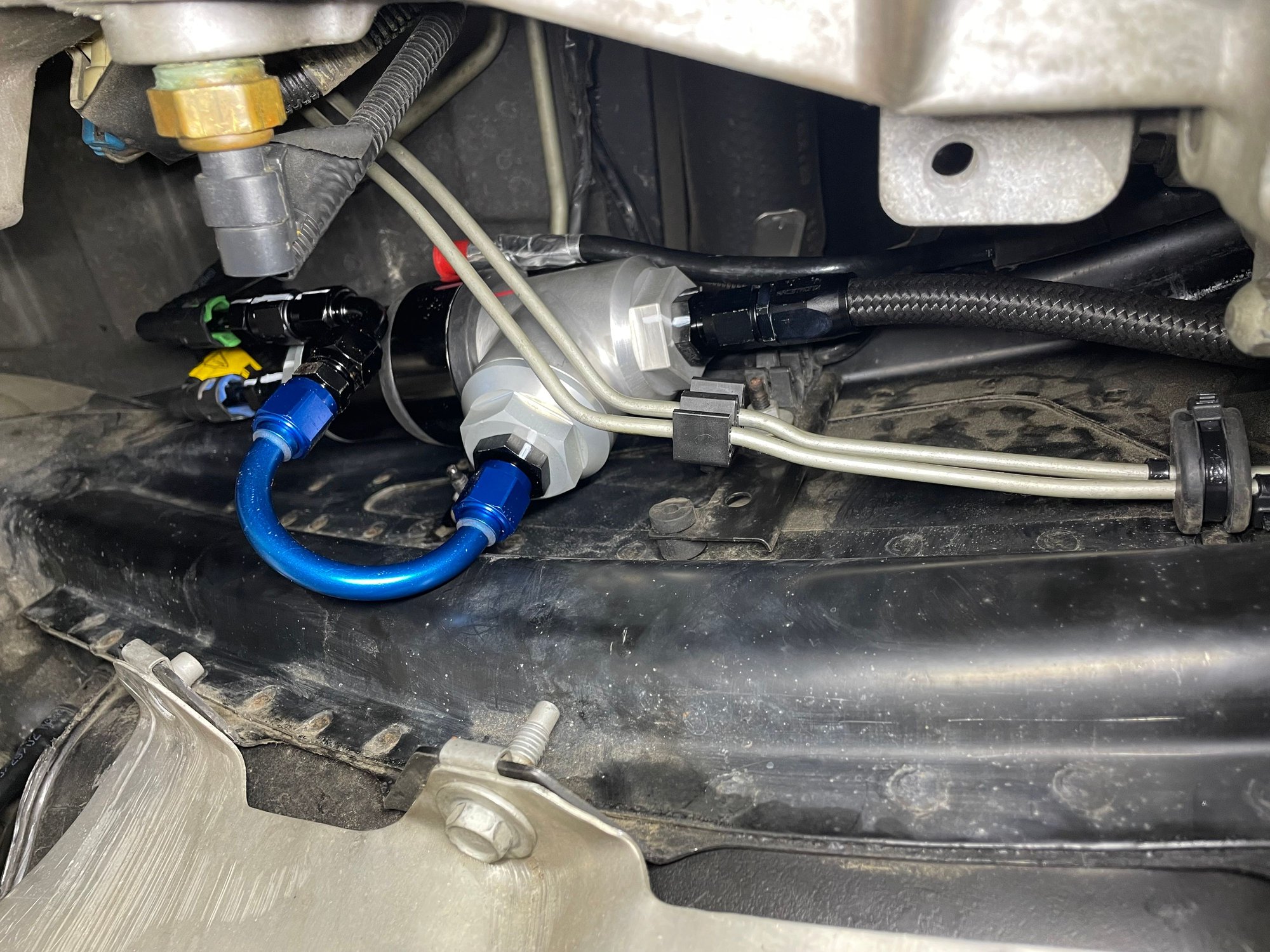

-I mounted the Holley filter/regulator in place of the stock unit and used AN fittings to mate to stock feed/return from the pump. A new 6AN line was ran to the motor. I needed to bend the brake lines out/around the new filter, but wasn't a big deal.
-At the motor there are more AN fittings along with the E85 sensor.
-Pump install...it's a pump install. Remember to unclip/unpin the sending unit from the assembly and remove it prior to removing the whole assembly so you don't damage it.
-Swap over the hat assembly to the new bucket/pump...wire accordingly and put it back in.

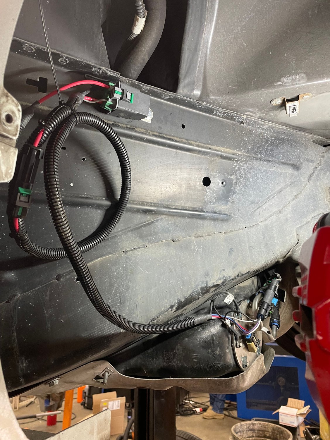

-Pump wiring harness was straight forward and ran through the DS rocker panel up to the motor/alt. (kept from having to remove the exhaust/tunnel plate).

At the time of writing this I am in contact with Holley about some strange noise/vibration coming from their filter/regulator assembly. I don't know if the regulator is bad or it is the combination of fittings used to make this work. So far they have said the install does not look like the issue. Awaiting more answers from them.

Filter/regulator noise has been greatly diminished by increasing the return line back to the tank with a 6an line:

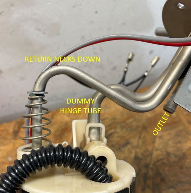

Most likely the cause of regulator noise. The restriction is already the 5/16" line in the return, but inside the tank seems to neck down as it is bent around:
This may be 100% fixed going to a simple -6AN bulkhead fitting on the steel hat.

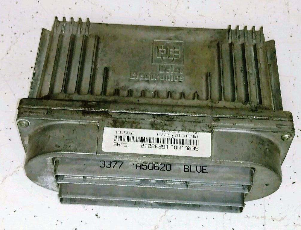

I need to get off my *** and add the sensor, I flashed everything else into the PCM using Aaron's thread. I did want to add a point of clarification though: the early C5 PCM was known as the LS1A and has less support than the P01. Both the P01 and P59 are known, at least in some circles as the LS1B PCM. The P01 is in fact a late PCM for the C5 as a whole, with the P59 being the latest.
Here's the early LS1A (monstrosity) PCM.
And the LS1B which could either be the P01 (512kb red/blue) or P59 (1mb blue/green, 2004 only I believe), they're identical in appearance. I forget what the year break is between LS1A and P01.
