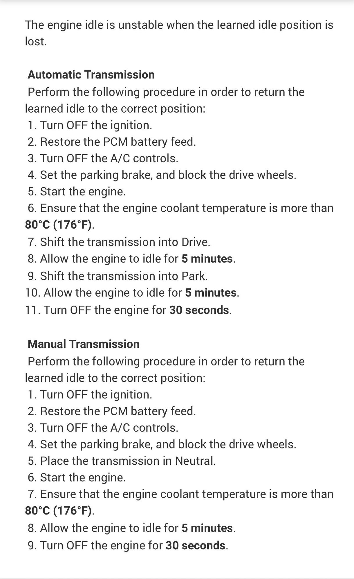

There is an idle relearn procedure in the factory service manual. My engine is modded, so maybe that's why it worked so well for me. But it made my idle sound like a milder cam was installed, and you could hear the change immediately.....
Non scan tool procedure below !!

YUP-Thats exactly what I did, Rob!!
