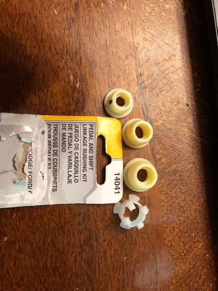

Does the shifter move at all or is it too stuck. Could just be the cable bushing. There are two of them, one at the shifter and one on the side of the transmission.
This is from my C6. The one with the black mark.

I’m worried about this also. How many miles you have on your C5?
You can get under the car by jacking rear then check if the tranny side failed. If yes get a Dorman bushing kit you may be able to fix this yourself. Also you can get the lever back in neutral by flipping the lever one notch forward if you are in drive — if the bushing is on cable then this means shifter side broke.
That's the kit I posted above
Yup - gotcha! I also split that bushing one side radially with a hacksaw to make ease of field repair easier to press on. Some other manufacturers actually produce that bushing with a split already in it. They are white.

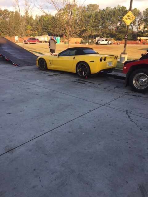

Originally Posted by officehound
Thanks for the video. I'll have to flatbed it to the local dealership. I do not have the ability to repair this myself.
Been there done that but a grand seems a bit much.I was stuck in park. Had to kinda "walk" the vette onto the flatbed. Getting it off the flatbed was like something from a stephen king movie.......
