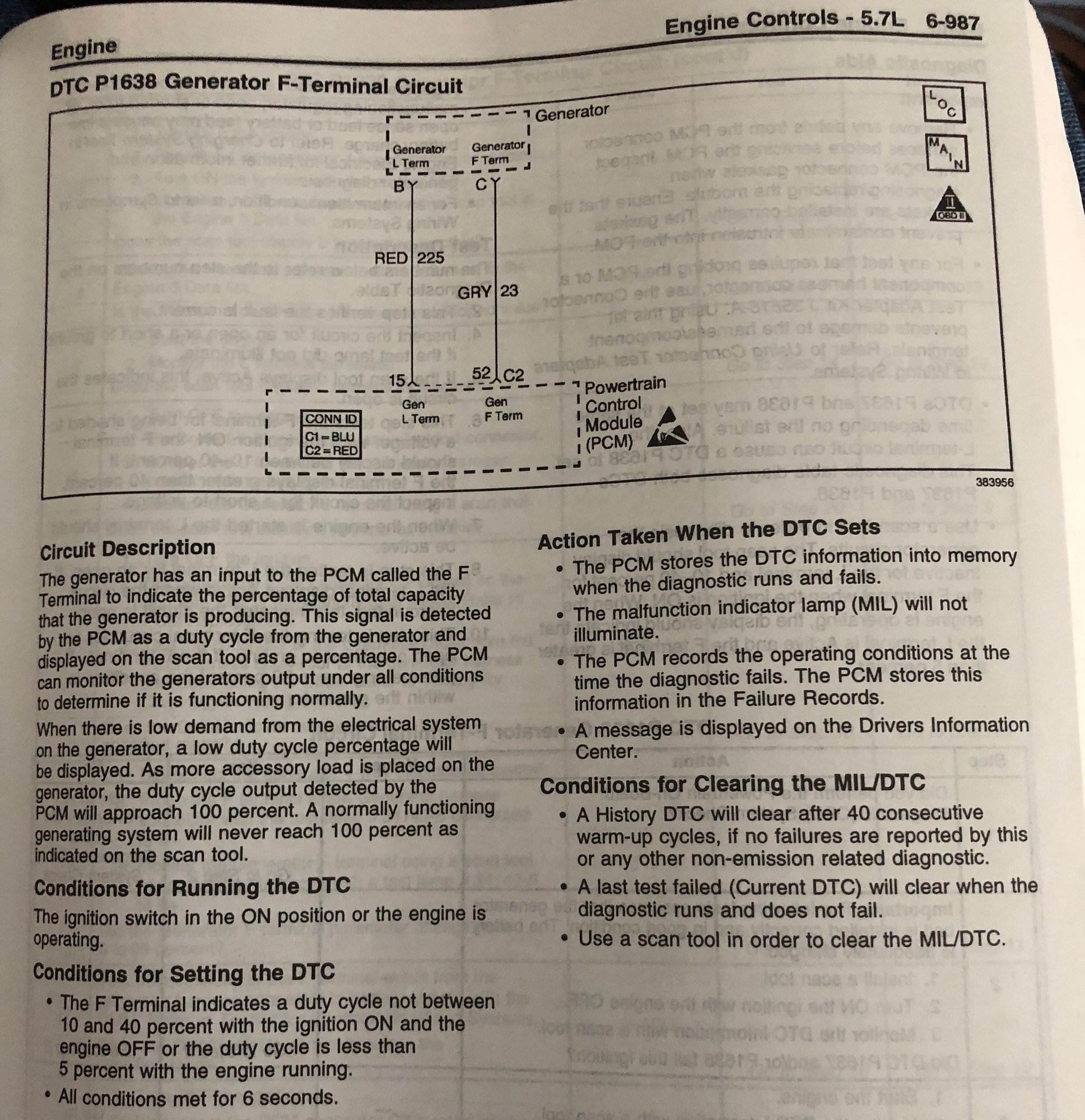

P1518 Throttle Actuator Control Module Serial Data Circuit
P1518
P1637
P1638

that there is a charge system fault when I turn the car on.
If you will look at the sticky threads in the above section you will find a section on the alternator in these cars. When yours was changed, the incorrect alternator was installed. That is why you are getting the charge system fault. it is not charging the battery
reading the sticky thread will explain in detail what I am talking about
