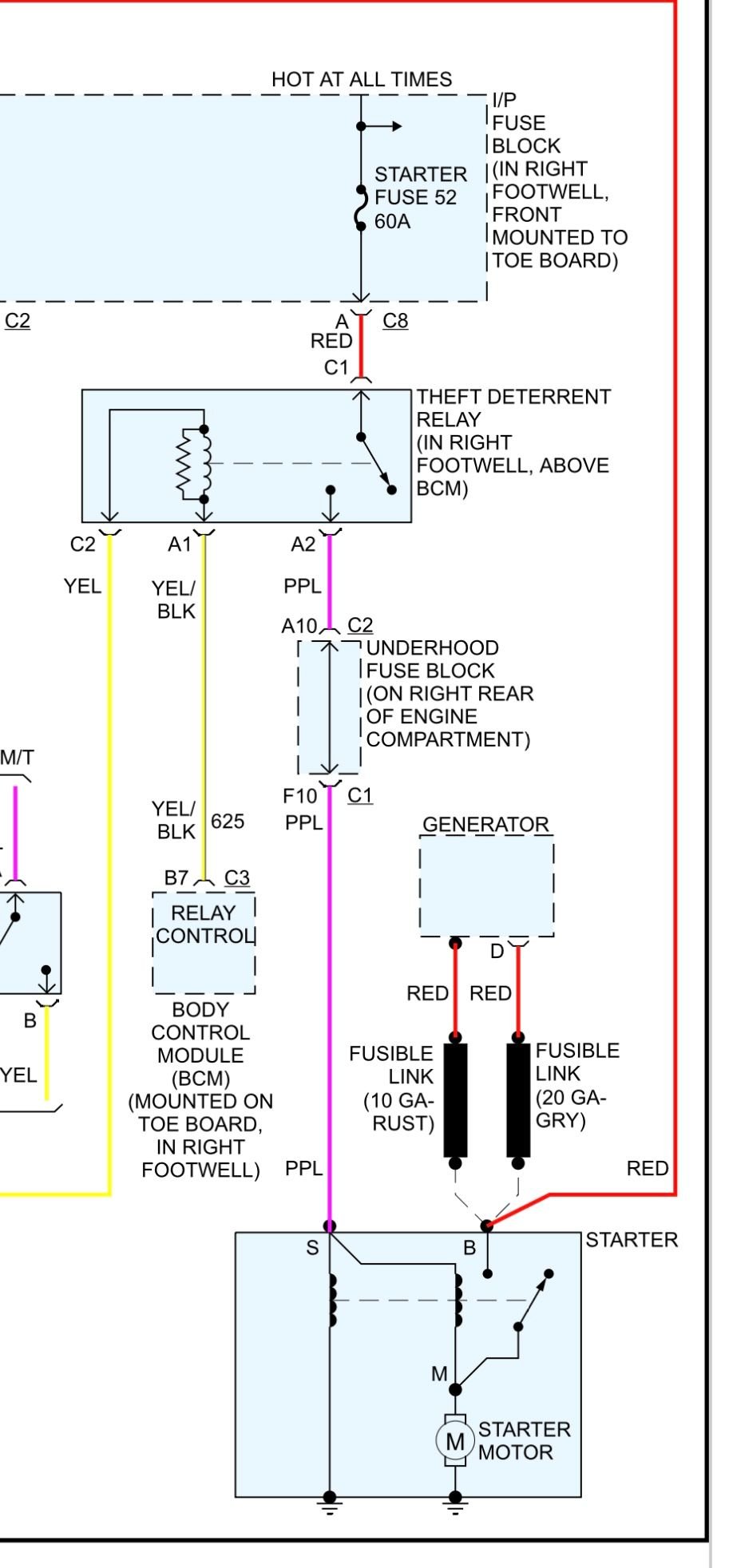

The buzzing your hear is the fuel pump…comes on and shuts off for 2 seconds…this may be an issue on the ground side of your starting circuit or a bad TDR relay…connect a 12 volt test light to battery negative and touch it to a clean spot on the engine block…while trying to start the car if the test light illuminates it’s a bad block ground…the battery negative ground is above the starter….TDR (Theft Deterrent) relay is above the BCM in the passengers footwell…with the car in N or P make yourself a pair of jumper wires and jump the RED to the PURPLE wires…if the car now cranks you most likely need a new relay.

Her is the relay located above the body control module . The pink wire is going from the TDR relay to the starter .

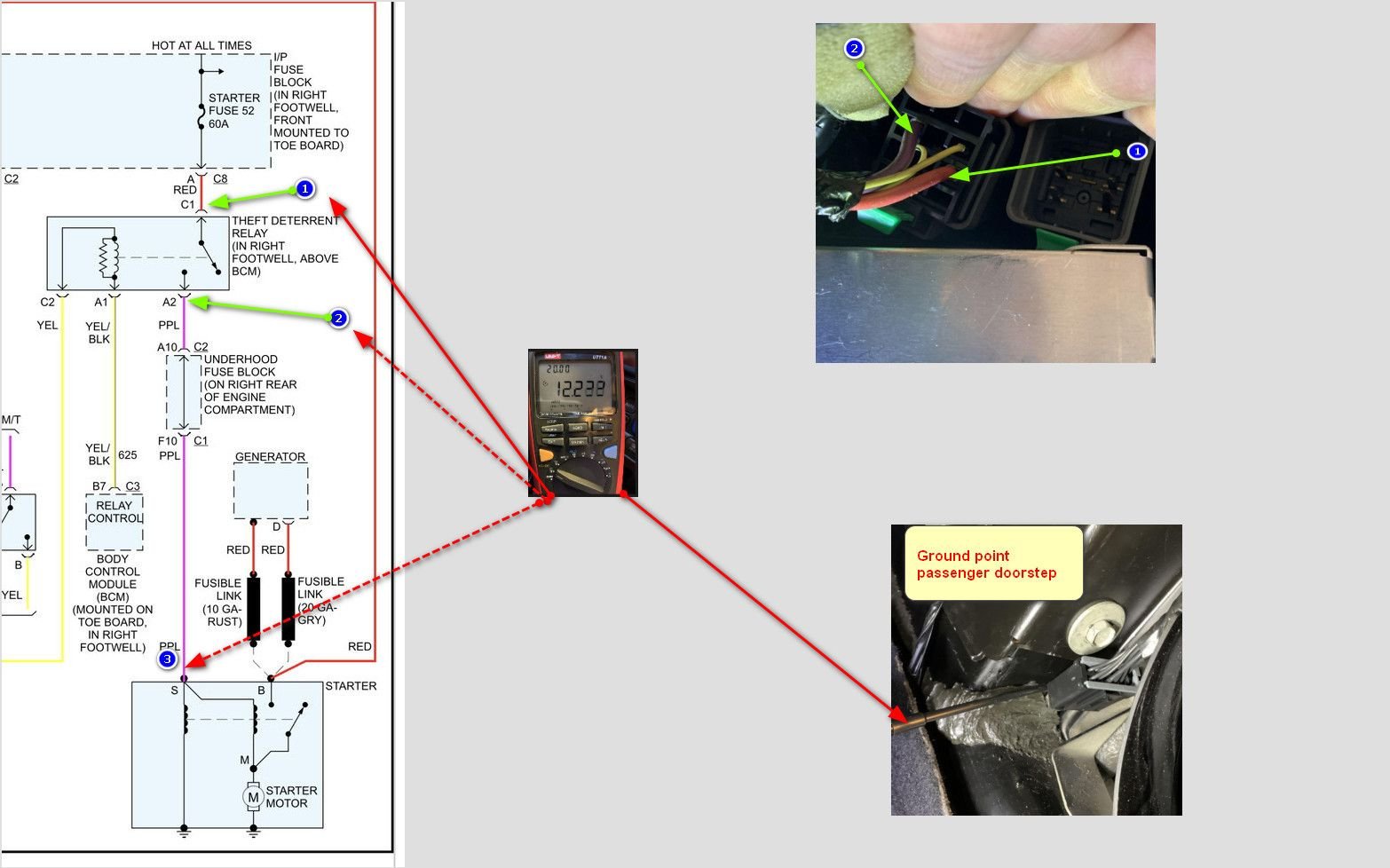

Do this three measurement :
1.Measure between a groundpoint and RED lead into relay socjet to verify if TDR get 12 v power.
2.Measure between a groundpoint and PURPLE lead into reaysocket to verify if TDR give 12volt power too the starter when you turn KEY to start position.
3 IF you measure 12 volt on line 2 above then connect positive lead of your multimeter to starter (3) and verify if the starter get 12 v power,
IF you get 12v on starter (purple lead) your starter solonoid may be defective (if the starter also get 12v from battery also)
