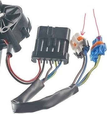

Lets say the OP's connections in his headlight plugs were dirty / corroded on the harness attached to the car (not the new plugs that come with the new motor) then that means maybe the plug has some broken plastic or the rubber in the old plugs on the headlight motor wore out or got dry and moisture more than likely made it's way into the plug. Could happen for many reasons such as parking the car outside, excessive engine washing, car exposed to extreme temperature change... etc. After the plugs are cleaned or even new plugs if the car is going to stay exposed to the elements or get a washed a lot of times, you can use dielectric grease to protect those connections. Like I mentioned in my last post sometimes seals go bad for those reasons. I never said you wanted to stuff the connections in a plug with the grease. It is used as a protector and if someone didn't know what it was they could look up how to use it or ask here.
I never suggested to use in improperly, I offered as a suggestion for after the plugs are cleaned as a way to keep them clean. And yes, you can use it on plugs like the ones in the headlight assembly with the rubber gromets. The orange rubber on the connections in the picture below to help seal the connection from water and moisture.
