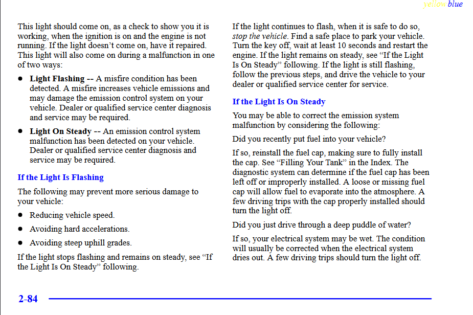

I thought that when a car's check engine light came on it was a signal to stop the car and figure out what is going on.
My manual makes it sound like it's emissions related issue- and mentions nothing else. If this is true, I just plan to keep driving it and set up a time to have it checked sometime soon.
Thought I might ask if there are any other thoughts on this.

The MIL will illuminate for anything affecting the emissions of the car…a flashing MIL is a cat damaging misfire and that you don’t want to drive the car without getting that taken care of…you know what code you have to see what steps are needed to fix it.

MIL (Malfunction Indicator Lamp) is the check engine light.

Any chance you filled up shortly before the engine light came on? It could be something as simple as a loose gas cap. A steady light is not a reason for panic. A flashing one, as C5 Diag mentioned, is a misfire and could cause an issue. Follow the instructions provided on how to pull codes and list the module and code along with the C (current), H (history), or HC (history and current). If the issue resolved somehow, the code should still show up as history code and the light may turn off after a number of key on cycles.
