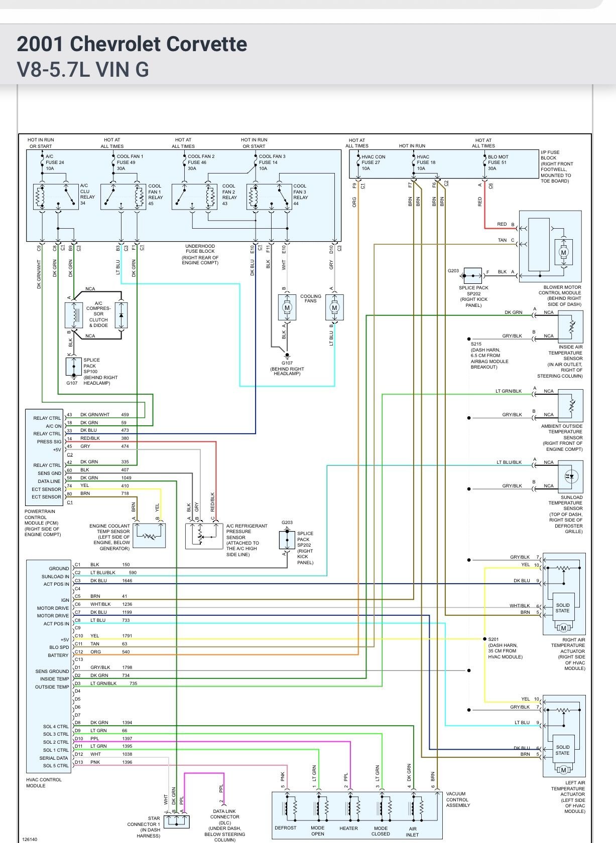

The on/off switch on my AC climate control module does not work. I removed it and made the 16 solder joints but it still does not come on. I am getting the small lights that come on. Is there a power relay or a fuse to replace before I locate a new or rebuilt unit.

I would first check to see if you have any trouble codes stored using either a scan tool or the DIC…you can check HVAC fuse 27 which is battery power to the HVAC module…see if you have any “no comms” stored in the HVAC module…you really need either a factory level or aftermarket bidirectional scan tool to see if the HVAC module is seeing your “input” to the module…basically your finger pushing on the AC button…if the input is good the module will see that input.
