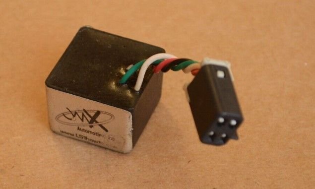

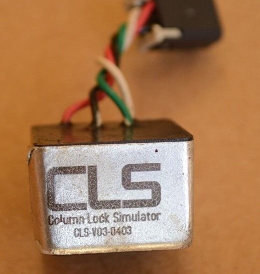

Mechanic's note:
"Steering Column Relay: FOUND THAT THE SECURITY LIGHT IS FLASHING. NOTICED MESSAGE FOR REMOVE KEY FOR 10 SECONDS. SEARCHED FOR BULLETINS AND FOUND #05081: Special Policy Adjustment - Electronic Column Lock System. INSPECTED THE COLUMN LOCK HARNESS AND FOUND THAT AN AFTERMARKET COLUMN LOCK RELAY HAS BEEN INSTALLED. WILL NEED TO REPLACE THE STEERING COLUMN LOCK RELAY."
This car belonged to my dad before me. Every new term to me is a can of worms. He also sent a photo of him holding a small silver thing with "CLS" on it, under which it says "Column Lock S_____" can't make out the last word. Will post photo

The aforementioned "Steering Column Lock Relay"

Looks like it says column lock simulator? Just a guess. But don't take it to the dealer. Get the CLB (Column Lock Bypass) or the LMC5. The LMC5 is the popular fix these days but I've had the CLB installed on my car since 2007 without any issues. Either one will work.
The CLB should plug right into that same plug when you removed that old one.

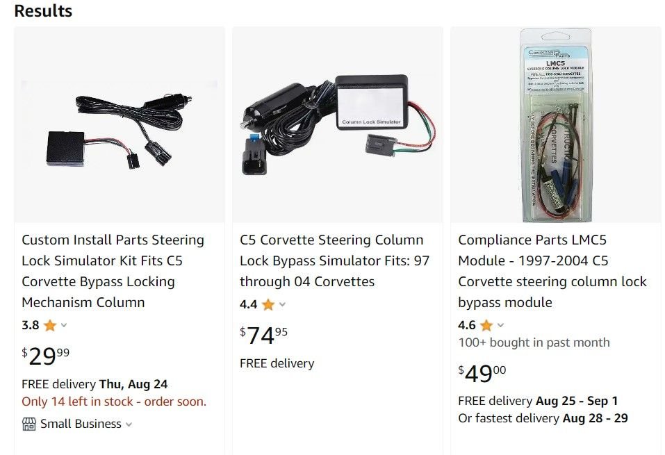

I found some PICs on ebay

I found another one

I think its just a version of the LMC5 they have them on ebay for cheap. I don't think you need one but they are on ebay.
Do a google search for column lock simulator and all kinds will show up.
