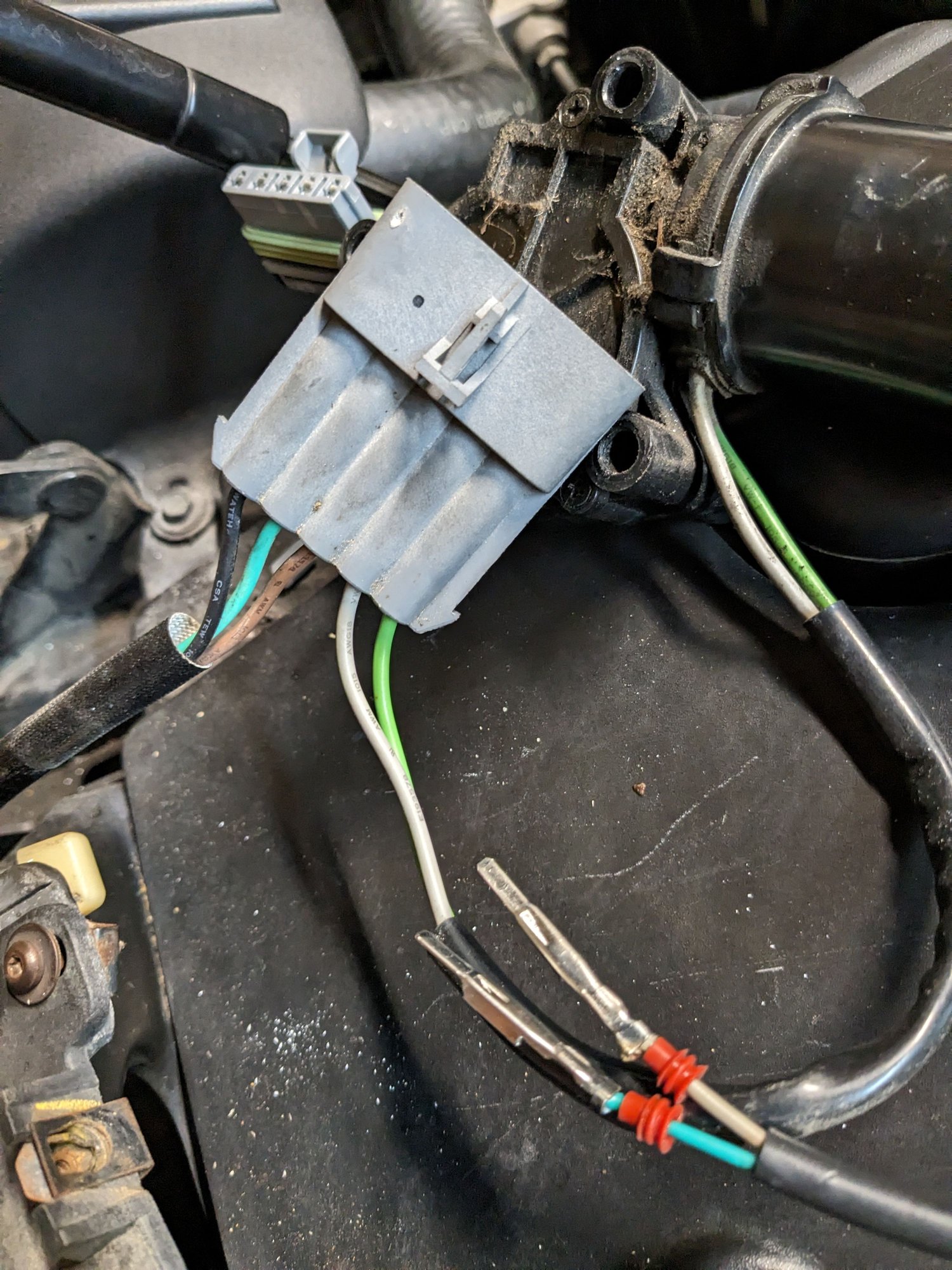

Wire loom from the other side
The two wires on the right side of the loom are from the old motor. They need to come out so the two new wires with metal posts can replace the old. They are tiny and I'm afraid I'll break something.

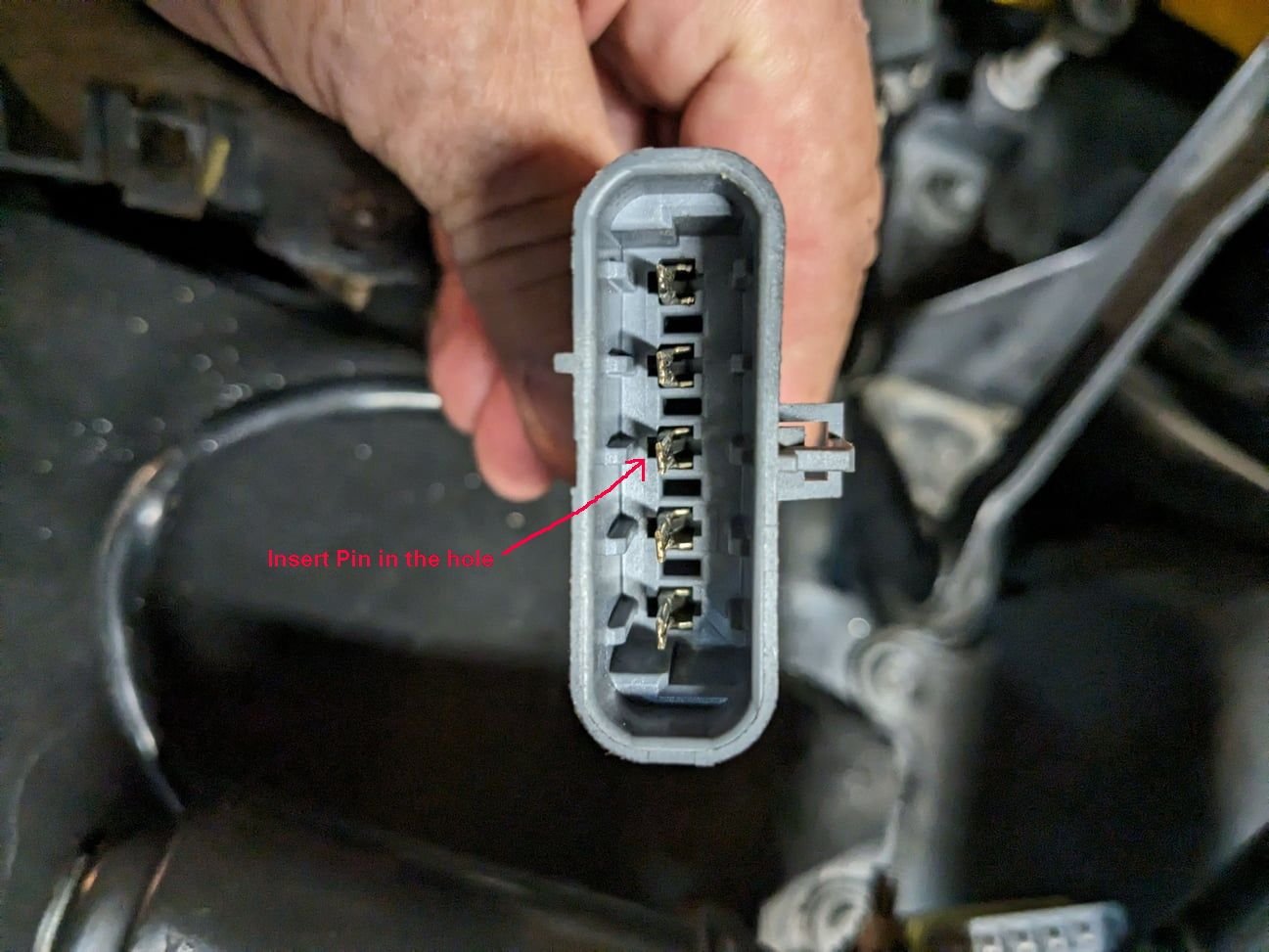

Insert a small flat screw driver in the hole next to the wire end. Get a set of terminal pin removal tools if you plan on
working on wiring connectors.

You can use a pick or a terminal removal tool or maybe a small paper clip. The pick is inserted into the rectangular area on the side of the connectors pin. Once you push it in far enough it will release the locking tab and the pin can be pulled out on the wire side. You can lightly pull on the wire when inserting the tool and when it unlocks the tang the pin will release.
