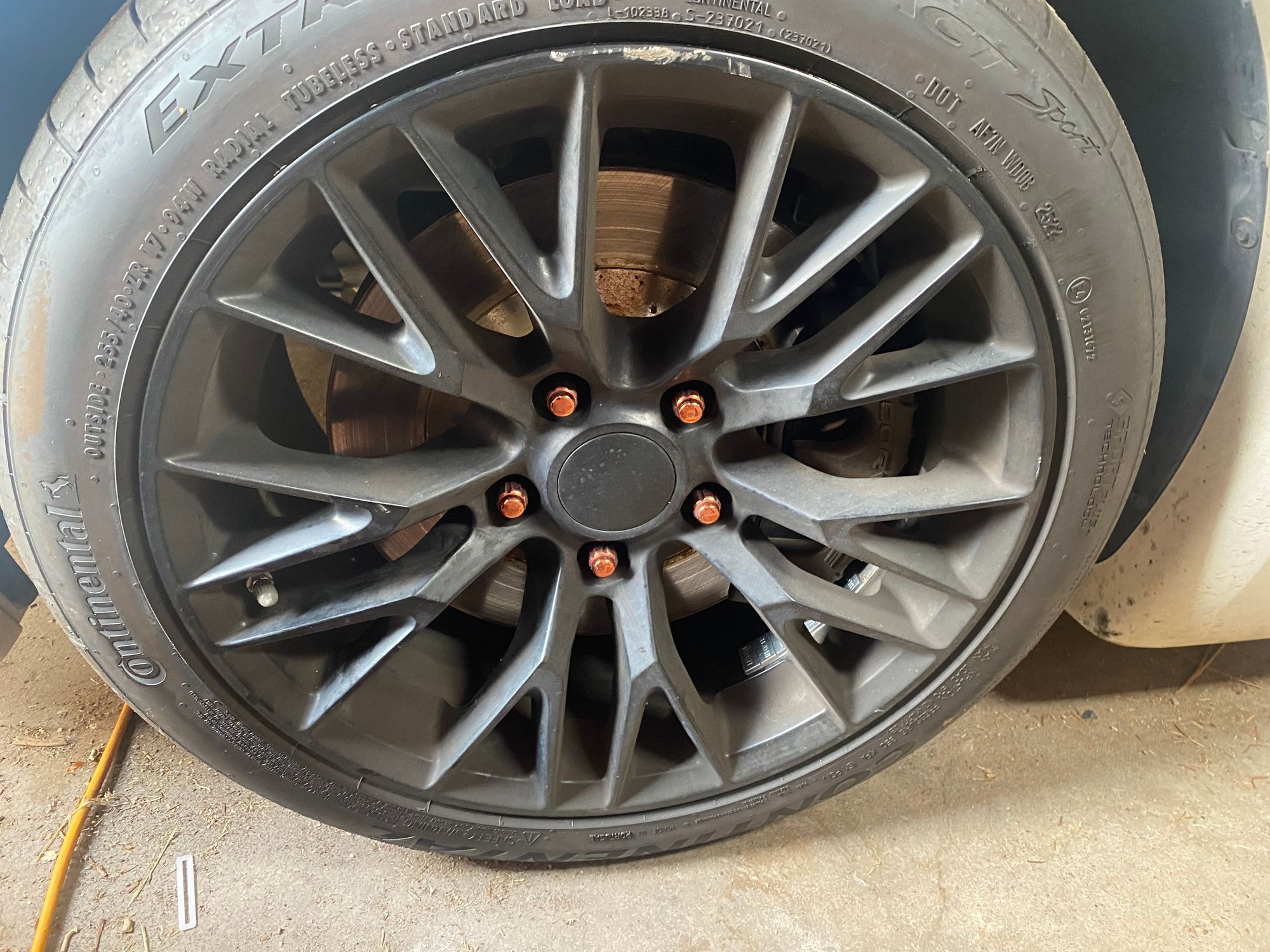

Hi all - had this issue for way too long and I’m out of ideas. I had new tires put on a while ago, and a few months following that, I got the “service tire pressure system” error. Two of the tires are showing the correct PSI (front left and rear left), but both rights are showing xxx.
It’s possible the sensors are both dead but I would guess that we’re just having a pairing issue and I need to reset the TPMS sensors. However, I’ve bought all manner of magnets but none appear able to trigger the first sensor (front left) during pairing mode. It’s particularly odd because that tire pressure is still sending that tire pressure to the cabin, so I know that sensor is actually still working. See attached pic.

I put it on pair mode, try and try and try, but can’t get the horn to beep and can’t get it to move onto the next sensor. The C5 has aftermarket wheels that another owner put on, which interfere a bit with getting the shrader magnet around the valve. But I would have thought that some combination of all of these magnets would have triggered it. The magnets seem really strong. I have included a pic of the wheels here.
