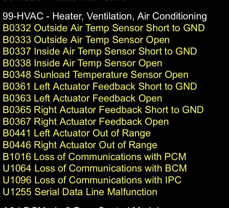

Most of us know how to find our codes and look up what they mean. My question is is there a list of codes that each module CAN produce? I'm asking because after much trouble shooting of my ac blower operation and not getting any codes at all either in the DIC or my scanner I have concluded that there is a vacuum line that is either loose or broken. My specific question is would a vacuum leak give a code? I'm thinking not hence the entire code list for the hvac module

The service manual index has a list of codes. Seems like that should be the complete list, otherwise if an unlisted code came up the tech would have to hunt in that section of the service manual.
This is one of the .pdf files from the downloadable manual pinned in the C5 general area:

Here is another listing I have for the codes for my '04.

Both are great lists so if they are a complete listing and I get none of the hvac codes it has to be either the vacuum leak or maybe the controller, while changing images in the mode selector setting isn't actually signalling the actuators.............but that would trigger a code..?
