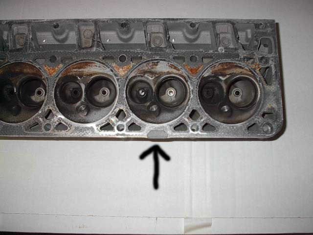

If you have notch in your heads, then dont use MLS-head gasket.

Hey Vette97sc,
Yes I have the notched heads. Are you sure you can't use MLS gaskets with that style of heads? I've seen a few conflicting pieces of information online.

I believe ws6store sells a notched mls head gasket. I know they did but not sure if they still carry it

Looks like michigan motorsports has them

Aah they make now MLS gasket to notched heads now. About 7 years ago when build my previous C5 engine, i take heads to machine shop and they weld notch.
