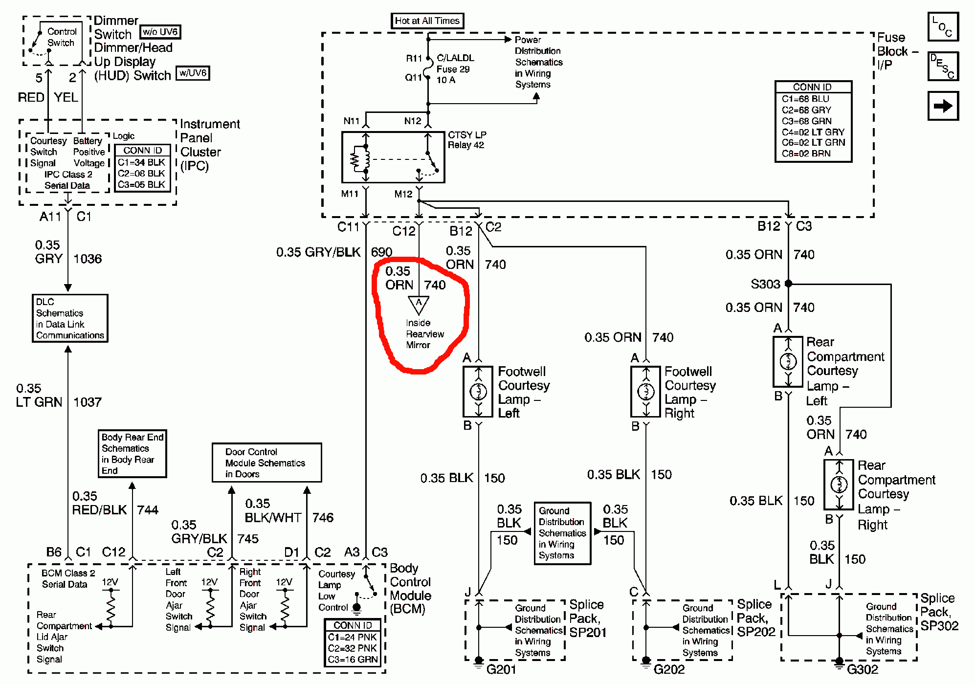

Do the light come on with Dimmer Switch on the left of the Instrument Cluster?
Are you getting 12V on Pin #6 when a door is open and the courtesy lights are on?

Are you getting 12V on Pin A when a door is open and the courtesy lights are on?
If you are, wiring in the mirror is bad, If not, there is a wiring problem going back to the CTSY LP Relay 42 in the I/P Fusebox.
Also, could be a bad connection in the connector.
