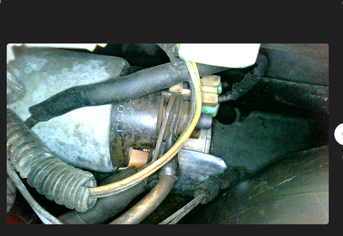

Yes, it looks like it might be caused by loose bolt on starter. I spent last few hours trying to tighten it from top, but theres just not enough room with headers. I give up for today and tomorrow I will maybe try it from bottom.
That doesnt look tight at all...

I would remove the cables and clean the terminals, loose connections like those tend to heat the terminals and cause a loss of conductive.

So I tightened that loose bolt, it was awful job but I suceed. Hower when I put everything back together, now that car doesnt start at all.. All it does is just 1 click from starter... My work order was: unplug battery, remove motor cover+air tube+2 spark plugs for better access from top, remove green conector on starter for better acces to that loose bolt, used contact cleaner and slowly and painfuly tightened loose bolt and then reversed that work order. So I think my easiest next steps now should be to check some fuses and try to jump start it / use different battery ? Before I go down to starter again...

You will have to pull the starter and replace the solenoid, those lose cables on the starter solenoid caused a voltage drop and generated heat which baked the insulator on the solenoid. I know it's probably not what you want to hear as pulling a starter off with headers is a pain.

Yes, thats not what I want to hear. But sadly it looks like it so far. Also I noticed, that it might be C6 starter/solenoid in my car, because there is some connecter and I dont see anything like that on C5 starters offered online ? Engine is LS1.

I checked it again and purple wire is definitely modified for c6 solenoid style. I just dont know, if whole starter or just solenoid is C6 or what model is it at all. Guess I will have to wait until its out, to find more clues about what replacement to order. I begun preparation for pulling starter out, it will be extra painfuly job without lift :/ Heat shield will definitely go on new one, as I dont want to have this problem ever again. I am also thinking about some locknut, because it seems like all that was caused by regular nut going loose.

Problem solved. I bought whole starter intended for 2008 base C6 (as my cars purple wire to starter was aleardy modified for plug style) and it fits and run good. Disassembling whole exhaust system because of headers was pain, but car now starts again as it should and battery charging is good again too.
