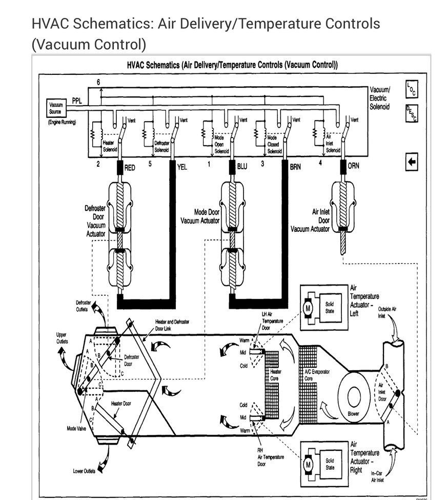

When you say 'doesn't work', you mean you don't hear the motor spinning up, as well as a lack of air flow, correct? It's just that it seems fairly common for fans to run, but if the vacuum actuators aren't working the air path sends output to all the outlets at once, including the defroster, dash, and floor vents. Plus, it's in fresh air mode which moves less air than recirculate mode.
If your vacuum actuators are working, then fan operation has three components: the controller with bad display, which sends a signal to a speed controller, which then sends power to the fan motor. With an '04, your controller and speed controller both use pulse width modulated signals. Member C5Diag will probably weigh in soon with better information that can help in avoiding use of a parts cannon (i.e. replace everything).

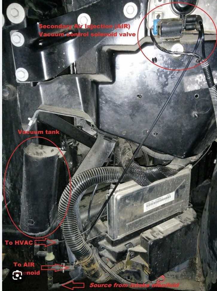

Did you change the resistor when you changed the blower motor? The most common place for a vacuum leak is here below the battery.
Old Sep 25, 2023 | 11:12 AM

Courtesy of C5diag:
To AC Fan mostly Not working
