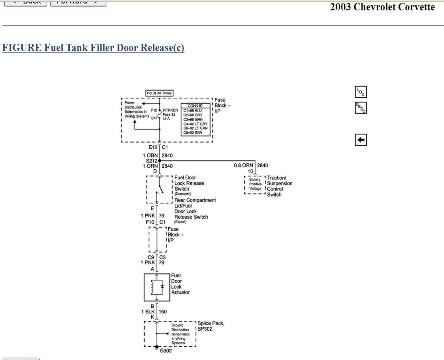

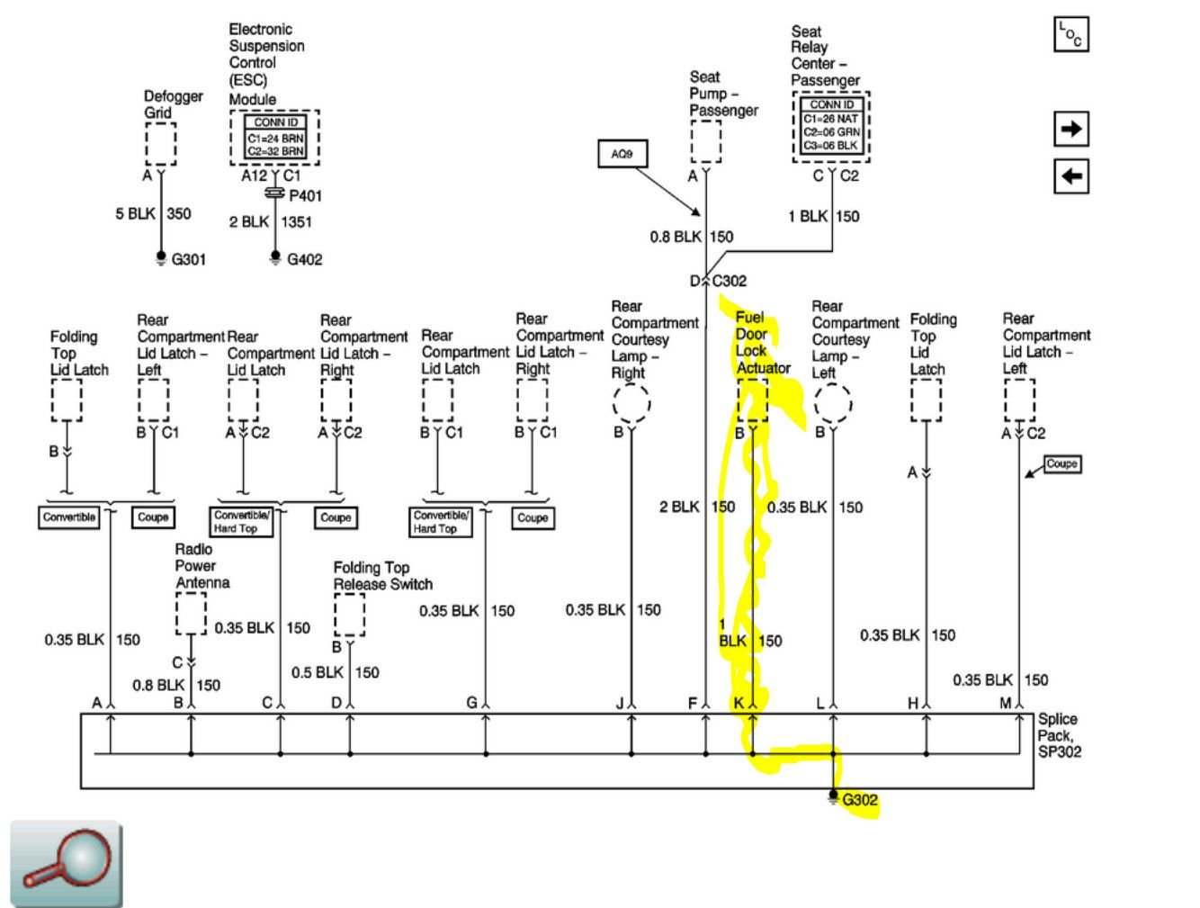

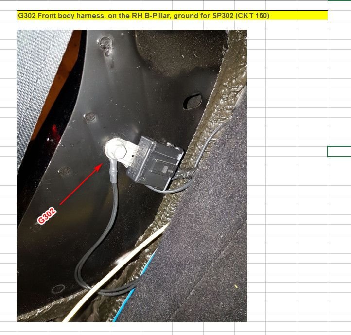

Try using a multimeter an verify if get proper voltage and has a good ground connection to G302 and within the splicepack connector (shown below)
Maybe the switch is malfunction or maybe the actuator , the multimeter should identify the bad component
