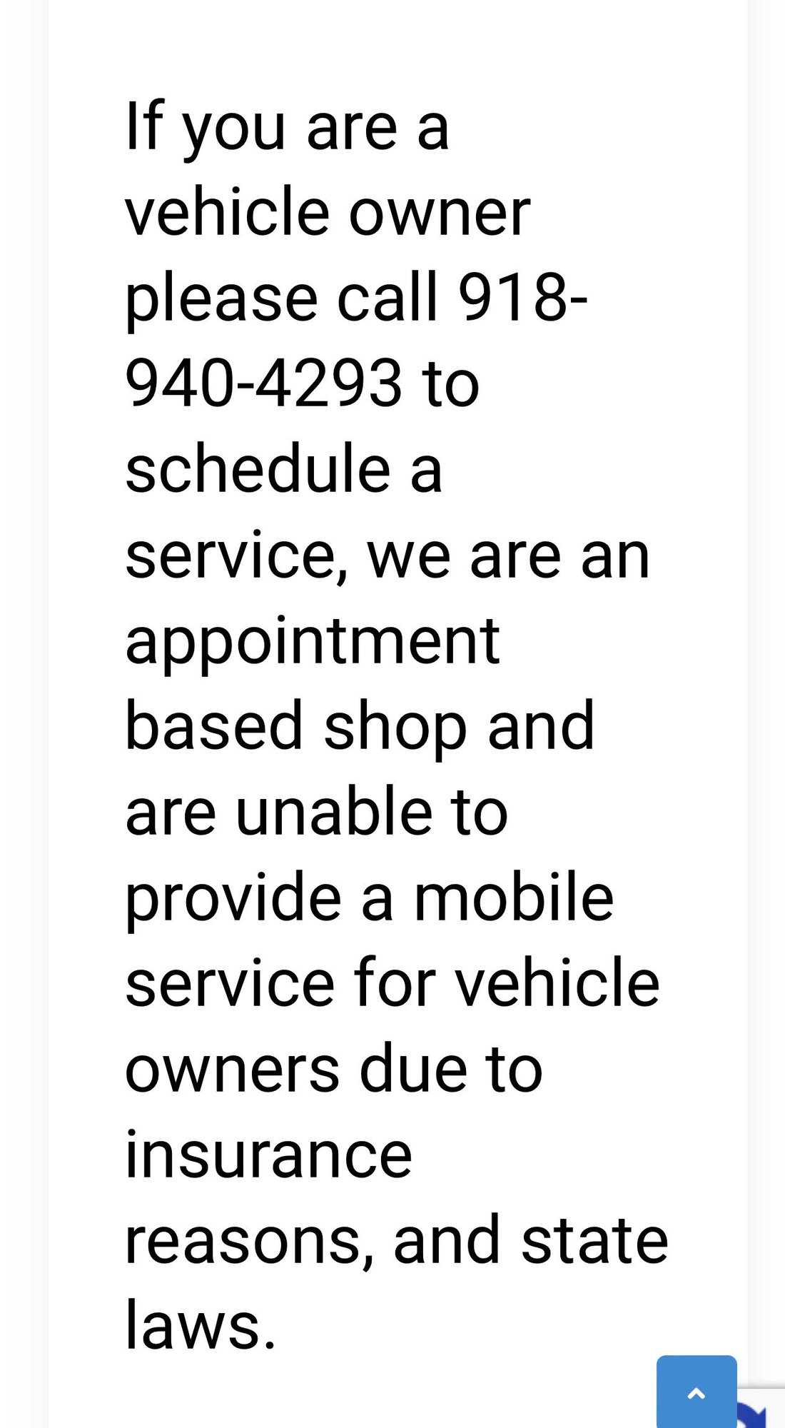

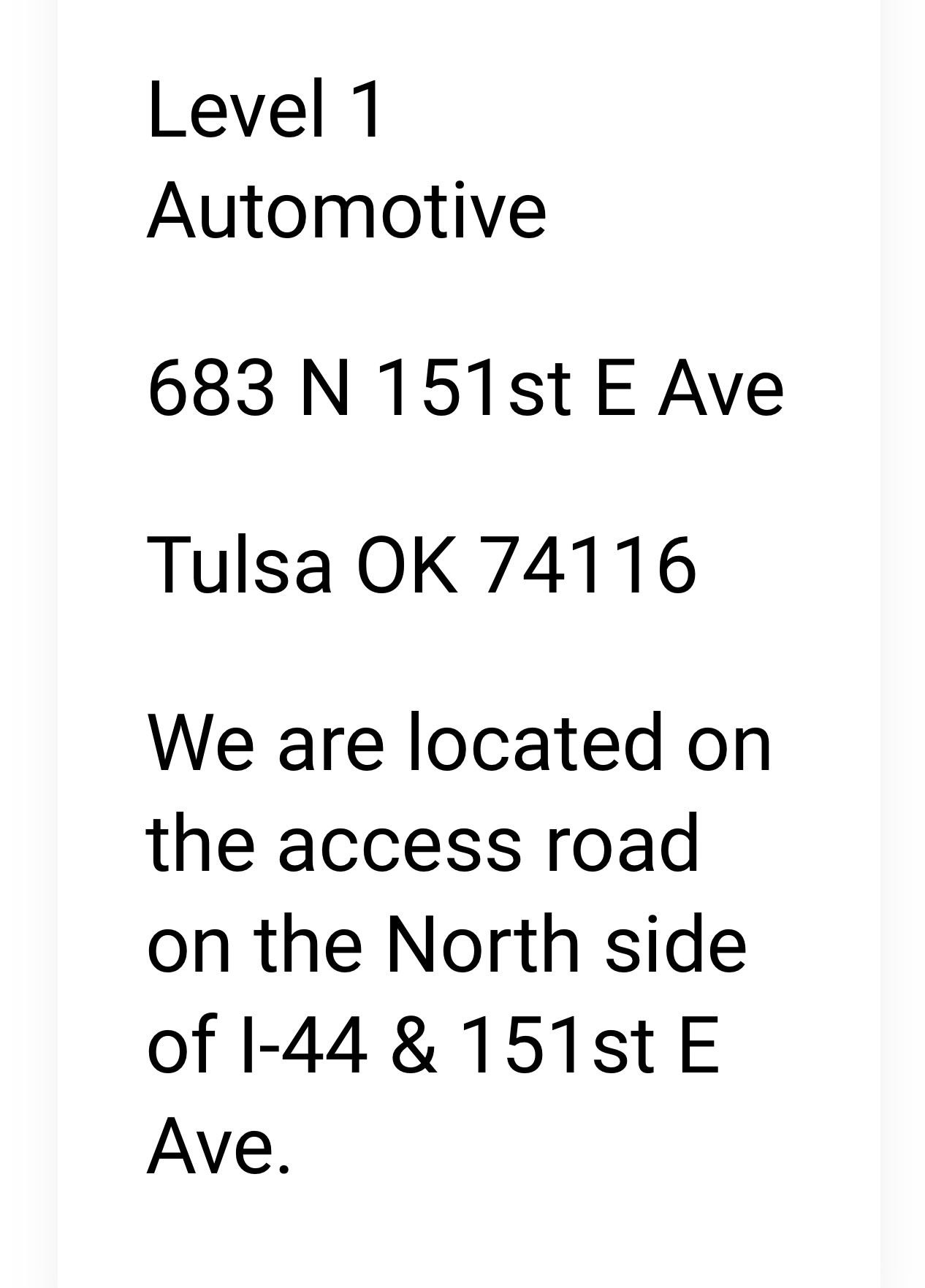

Your Father-in-Law needs to take the car to a diagnostic technician and not a Corvette “mechanic”…when someone says I need to take my car to a “mechanic” that is someone who can change parts…L1 Automotive Diagnostics and Programming provides advanced level diagnostics and Keith Perkins is a vehicle security and immobilizer expert and is a trainer in this field…info and a video below…he is about 90 minutes away.
