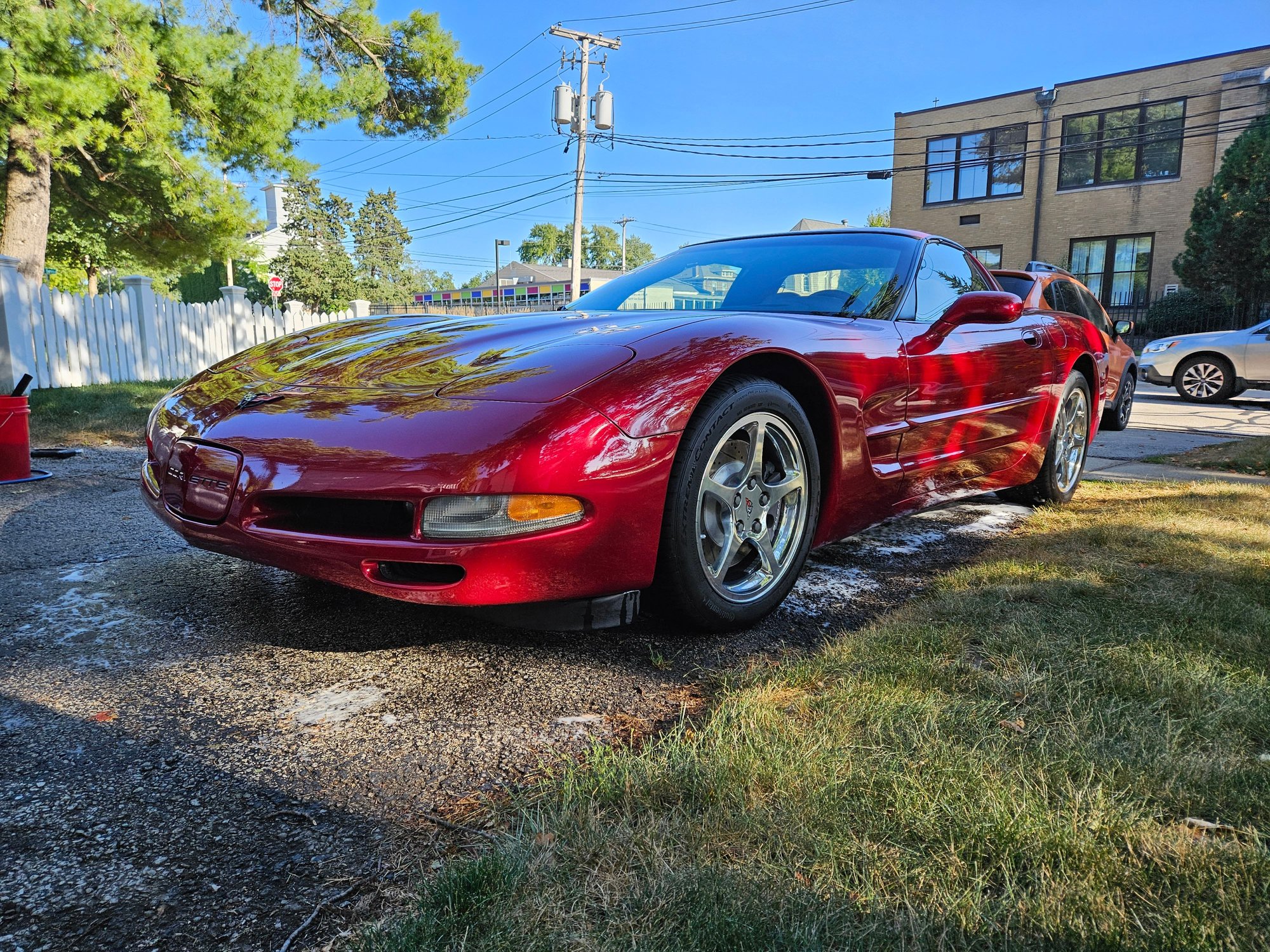

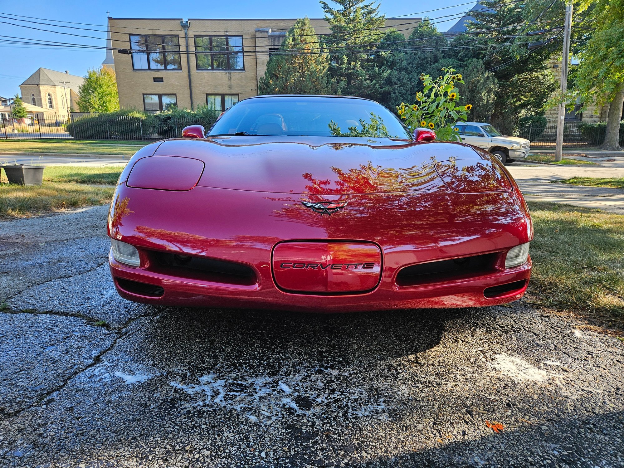

Hi All,
Purchased the car early this year and have been loving it. It's a 6MT, 58k miles and is all mostly original, so I'll need to do some maintenance. Original harmonic balancer is wobbling a bit so will need to change it. I also have Amsoil for the trans and diff, just need the time to do it. I'm betting it's got the original fluids still in it.
