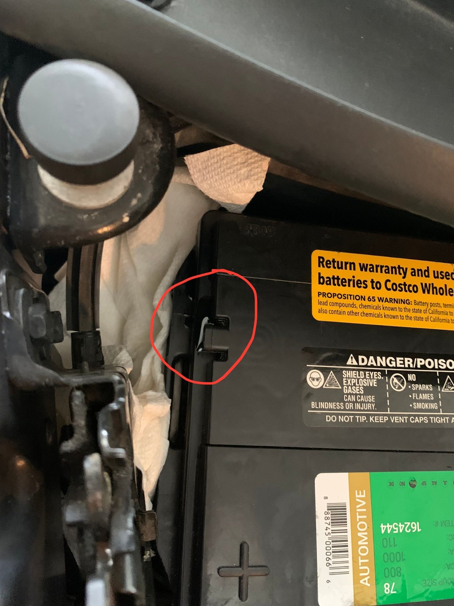

Replaced my battery with another interstate from Costco. I keep it on the battery tender and as noted on a different post, it’s leaking quite a bit. I returned the two week old one and now the new one does the same out of the vent. Prior one leaked so much it was puddles up underneath the battery tray.
At the suggestion from another member, baking soda does makes it bubble. With the battery tender plugged in, the volts range from 12.80 to 13.33.
Thoughts? Two bad batteries?

get a glass mat battery or you will soon have problems with the wiring harness under the battery.
AGM batterys do not leak

Theres no way that a vented type battery like that belongs in a C5!! Wrong application! There is a vent piping system that this type battery comes with when installed as an OEM battery in a new vehicle. Even if your battery didn't "leak," the vapors coming out are highly caustic/acidic, and will rust and corrode everything within several feet. You need a sealed battery, or better yet, an AGM battery, as suggested. That one is the kiss of death for your electronics AND frame!!!

Your battery cells electrolyte levels are too high. Someone put too much electrolyte in your battery cells. Check the levels by removing the vent cap(s). The level should be just at the bottom ring.
The guy at Costco is overfilling the batteries.

That's an indication that your battery tender is constantly trickling that battery. You're boiling it. To prove it, approach the vehicle after it's been sitting for many hours on the battery tender and check with a voltmeter then disconnect the battery tender and see if the voltage of the battery is slowly dropping. After disconnecting the battery tender. A quality battery tender will not constantly trickle and boil a battery. You likely have one of the cheap Chinese garbage ones. And yes get a glass mat battery. A vented battery will always destroy all the computers because the fumes are heavier than air. You already did the damage

Thanks for the comments and help. I am using a battery tender plus brand. They no good? I installed the new AGM battery yesterday and returned the Interstate to Costco. Funny, as I took the vette out to the dump to drop off the old oil, then tried my older SEM-1562a float charger and nothing leaked out. I then put the battery tender plus back on and nothing leaked out this time either!!! Maybe after bouncing around and loss of some of the liquid, it leveled out. Regardless, keeping the AGM. I removed the battery tray and cleaned underneath.
