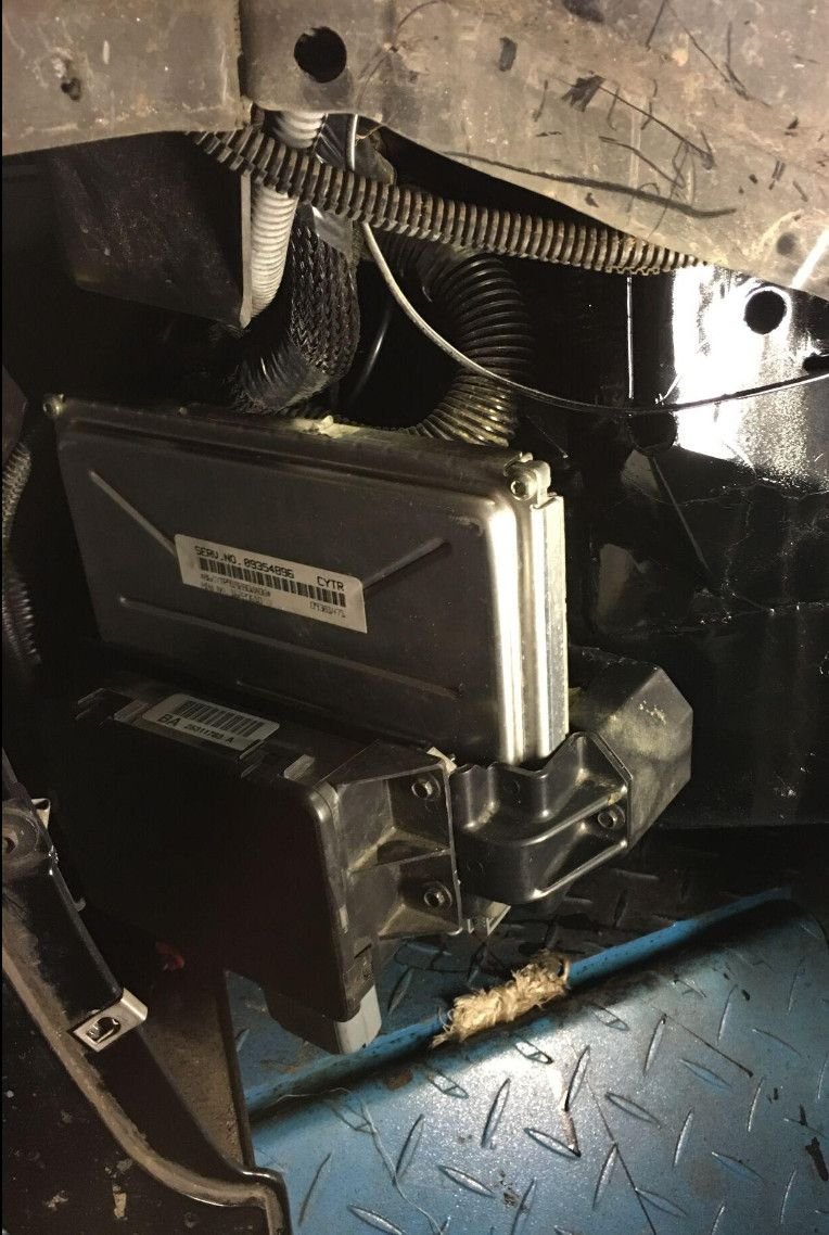

Have you inspected the tac modules (black box infront of the PCM) regarding water intrusion ?

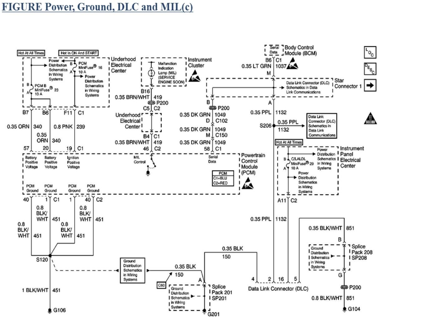

I just got around to probing the connectors due to rain last night, and me not wanting to worsen the problem. The TAC looks to be good. After probing the PCM connectors, I have good ignition voltage, but no battery voltage on both orange pwr wires. Based on the diagram you sent yesterday, the orange PCM wires go to fuse 23, which was good but had no voltage on either side upon probing. I tested the TAC wiring and had no ignition voltage (pink wire), further following the circuit to fuse 17 I had no power there either. The only TAC wire I had power on was the grey wire on the larger 16 pin connector.

If you have no voltage to fuse 23 which is hot at all times and comes from the battery fuses 52,53,4,3, and 51 will not be powered and your horn will not work…fuse 17 (THROTCONT) will also not be powered because the same circuit that powers fuse 23 also powers the Ignition Relay 42…if ignition relay 42 is not powered you will not have power to the coil packs and injectors…you may have a fusebox issue.
