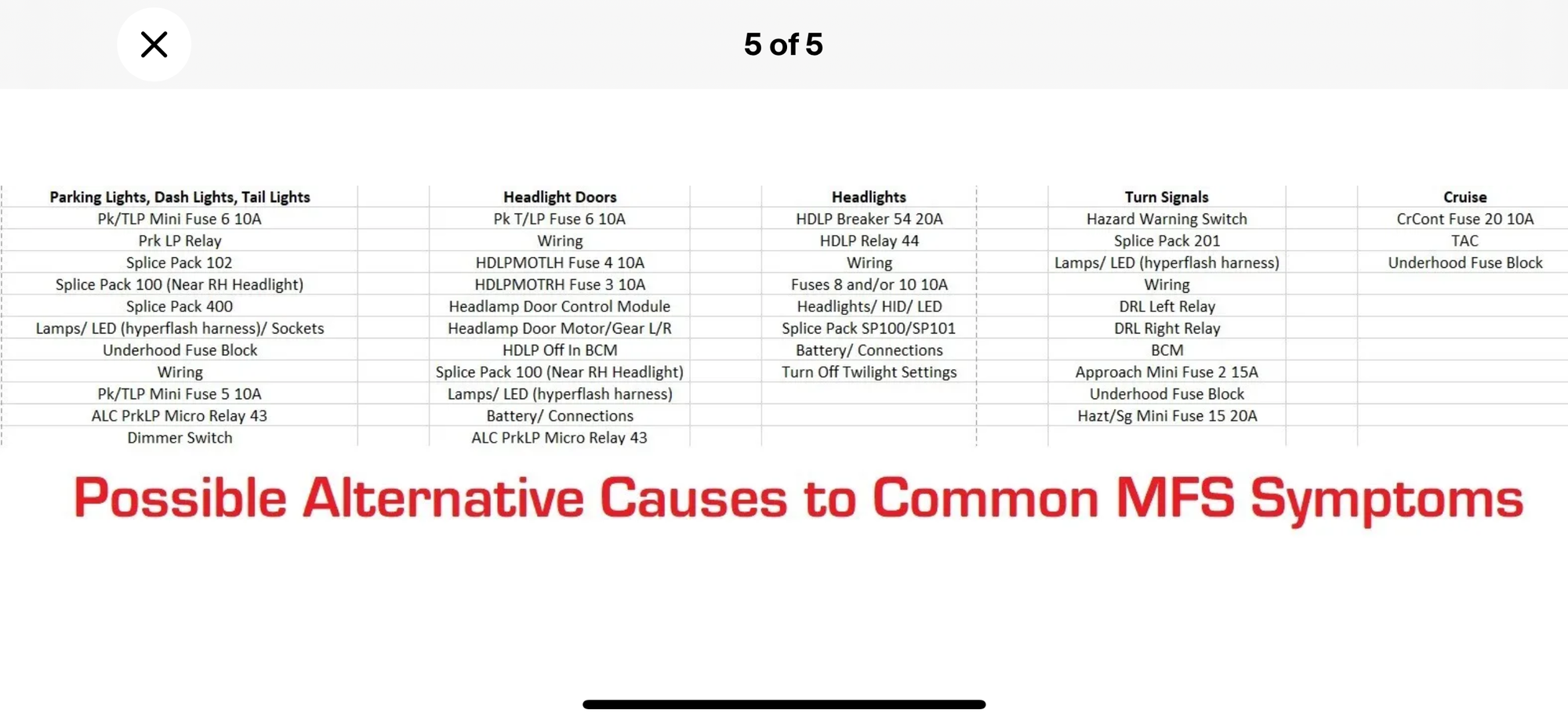

Howdy! The Sentinel setting should be disabled to help isolate.The multifunction switch tends to be the source for any lights stuck on, definitely worth testing it. The parking light output is Brown, terminal R. MFS has 19 circuits going through and is an easy target but I put the chart below together in case it is ruled out.
