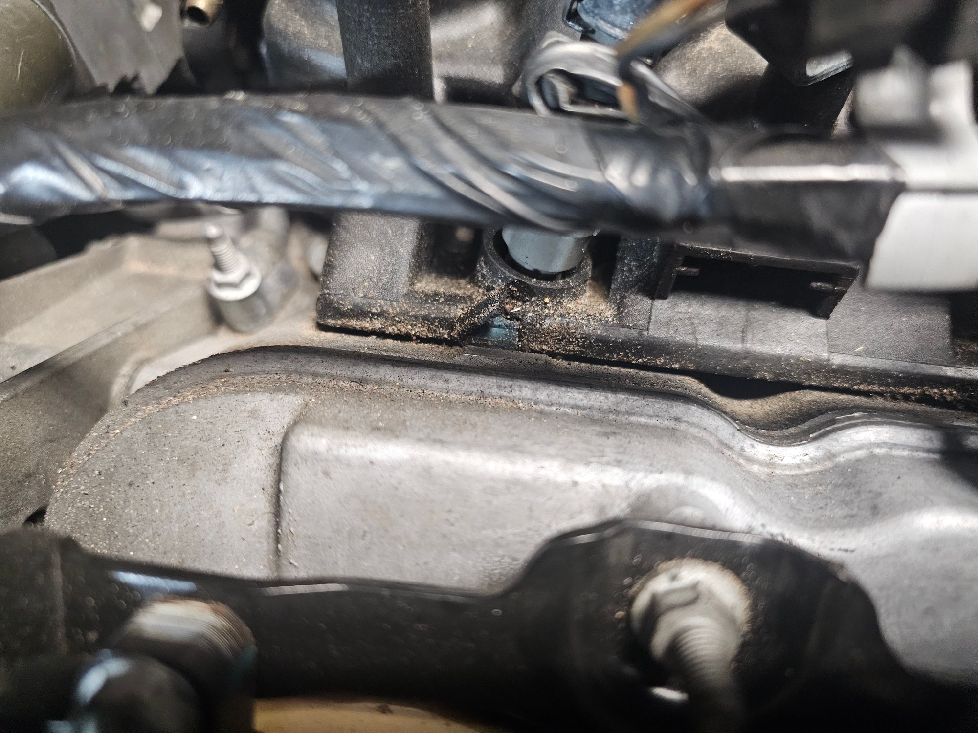

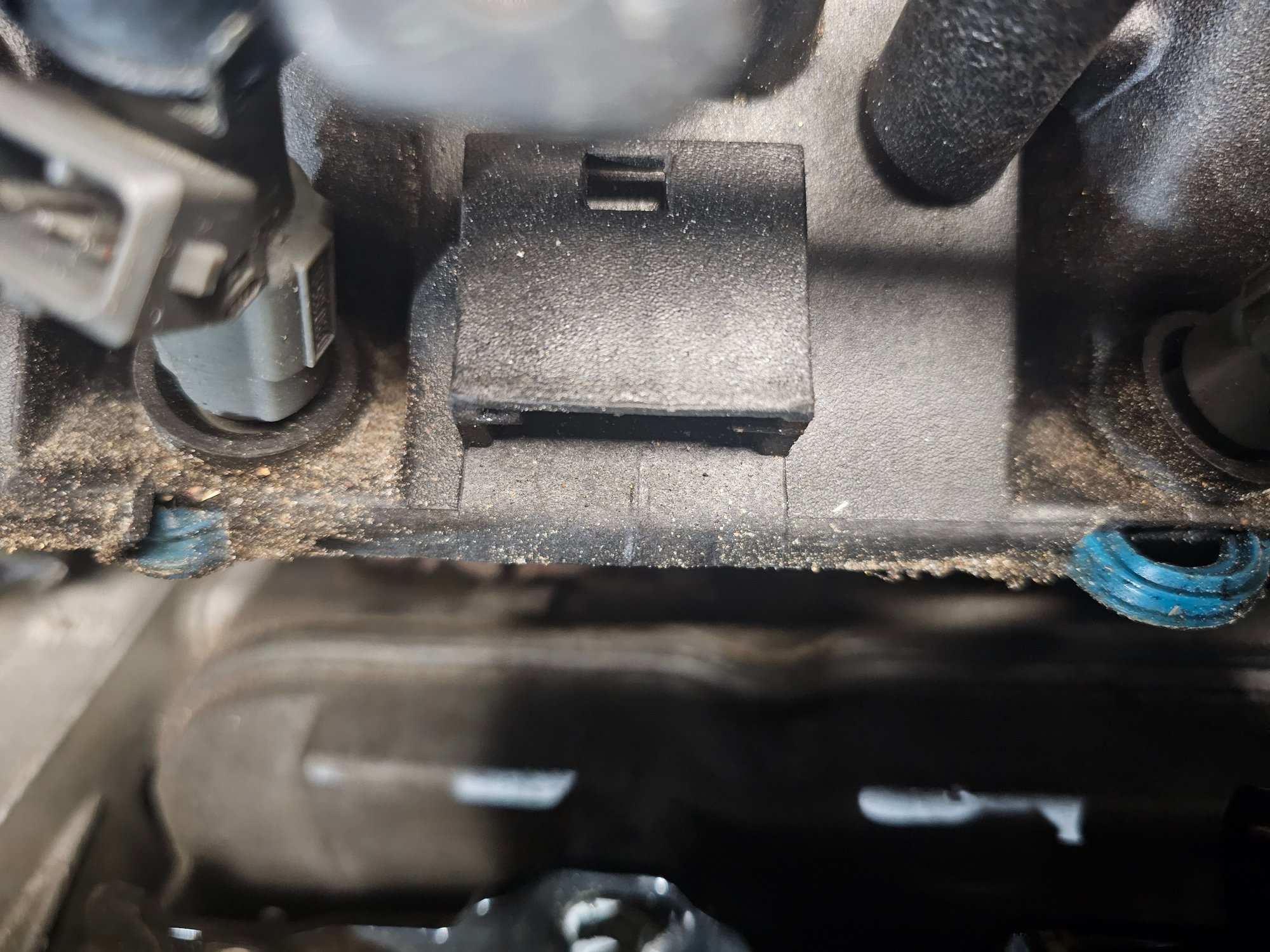

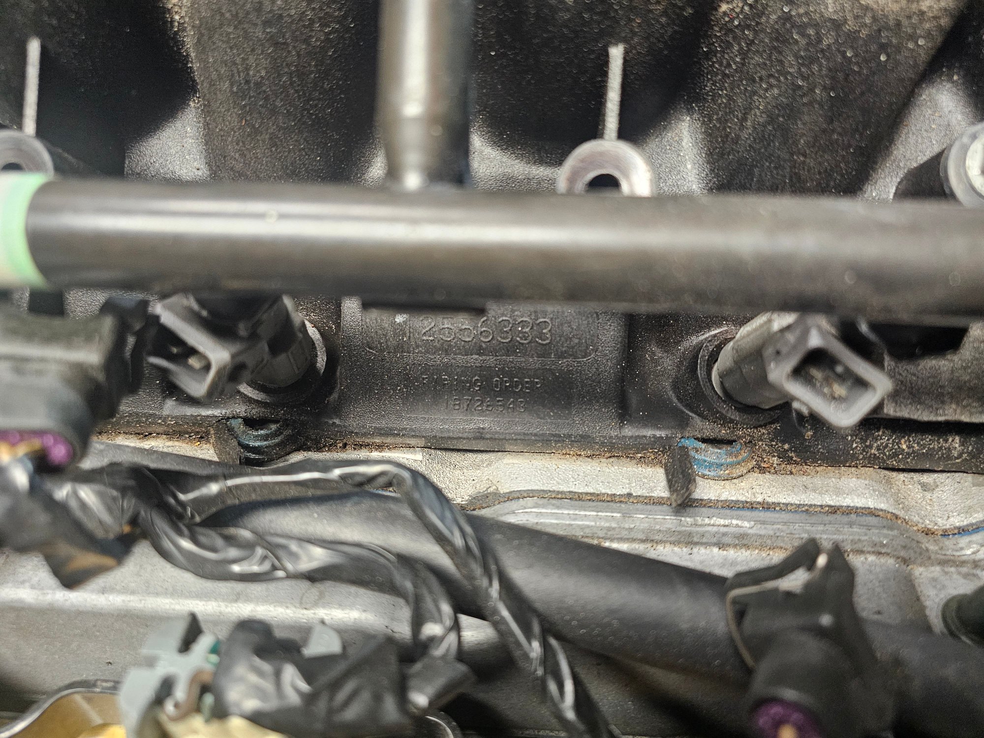

What the hell? I torqued the manifold to the proper in/lbs specs and 2 passes in the proper order. When I was doing my oil pressure sending unit I took the intake on and off like 8 times so I know I didn't screw that up. I practically had the procedure memorized.
Gaskets are what I thought were high quality ultra power. It's like they pushed themselves put. This explains the vacuum problems. I suppose I should reinstall new gaskets and rtv the outer edge? Or do I need to get a new intake?

No an LS7 intake won't fit and no RTV and new gaskets won't work to fix this. You have cathedral port heads on the LS1/LS6. Same for LS2 (so any of those 3 intakes will work the LS6 being the better of the 3). Or upgrade to a FAST and new TB. The LS7 intake is for rectangle port heads. Same as the LS3. So these 2 are a no-go.
You likely had a backfire cause that. Or the gaskets were bulging and you didnt realize when you torqued the intake down. Either way the intake is shot and you may want to check for issues with the engine. If it was runjing fine before your R&R with those new gaskets odds are good you had a bulge or bulging gaskets when you torqued the plenum down. Boom!

Everyone is correct,, YES,, That manifold is trashed. The gasket groove is compromised and will never be reliable again. Then again, what caused it to break?? If it were ME, I would install the manifold on the heads WITH OUT GASKETS / SEALS and insure that it sits FLUSH on the heads with out bolts, doesn't rock or have any major gaps anywhere. If the manifold cant sit flat on the heads, those gaskets / seals will extrude out of the groves. and never properly seal.

Can you pull the intake manifold and show us a pic of the sealing groove and sealing surface?? Something is fishy! It may NOT be broken . Just need to be able to see it to make a solid recommendation.

The gasket should fit in the grooves of the intake snugly. I've had intakes off plenty of times, never had a gasket fall out. It looks to me like the gaskets lost their placement in the grooves in the intake when you placed the intake on the motor but, that is speculation. Agreed with Bill see if the intake seats down flat, if the grooves aren't damaged, some new GM gaskets if you can get them should do the trick. If the intake isn't holding the gaskets in the grooves, I'd get another intake.

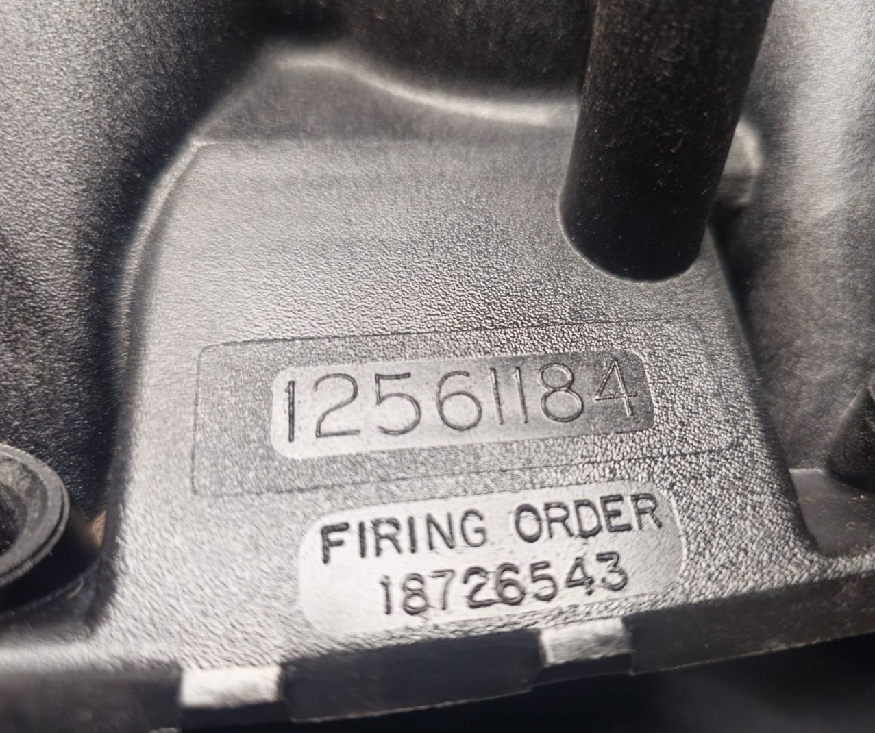

Thank you to everyone for your replies. It helped me make a decision on what to do. I bought an LS6 intake that apparently came off an 01 to 02 f-body. From what I have read this was a good iteration for the LS6 intakes. Car is up and running like a champ. No hiccups and I did not need to shave down the ribs. I tried my damnedest to get the greased-up coolant crossover pipes to touch and could not save for one tiny spot. Thanks again everyone!
