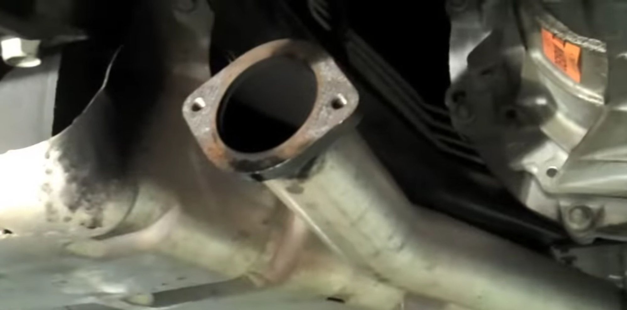

Picked up a used borla cat back. Made an initial attempt at removing the bolts that hold the stock muffler pipes to the midpipe. I presoaked the bolts for 2 days - the lower bolt on the passenger side had some movement. The upper bolt snapped off in place - so I've paused before I move ahead...
1) what is the size of the bolts so I can buy four new ones. Hesitant to move ahead without replacements on hand.
2) advice on how to remove the snapped off bolt? It's definitely at an awkward angle and location for access

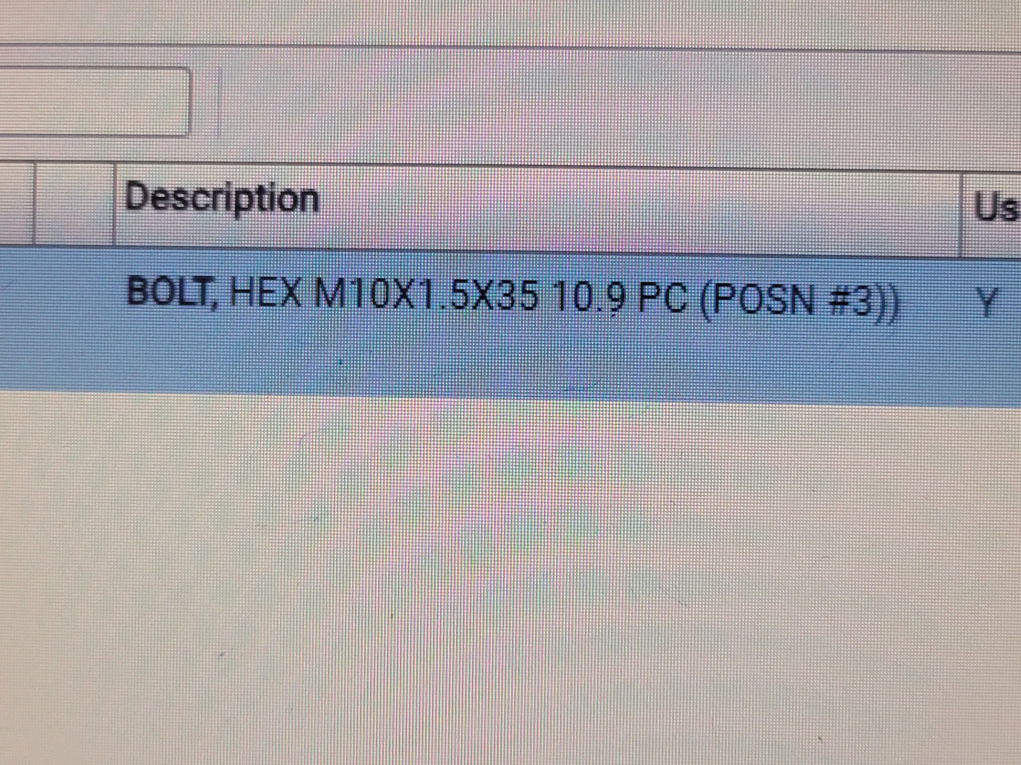

Stopped by the dealer. Confirmed the bolts and picked up replacements from an industrial supply shop. The are not grade 5 as other have said in other threads... they are 10.9 .

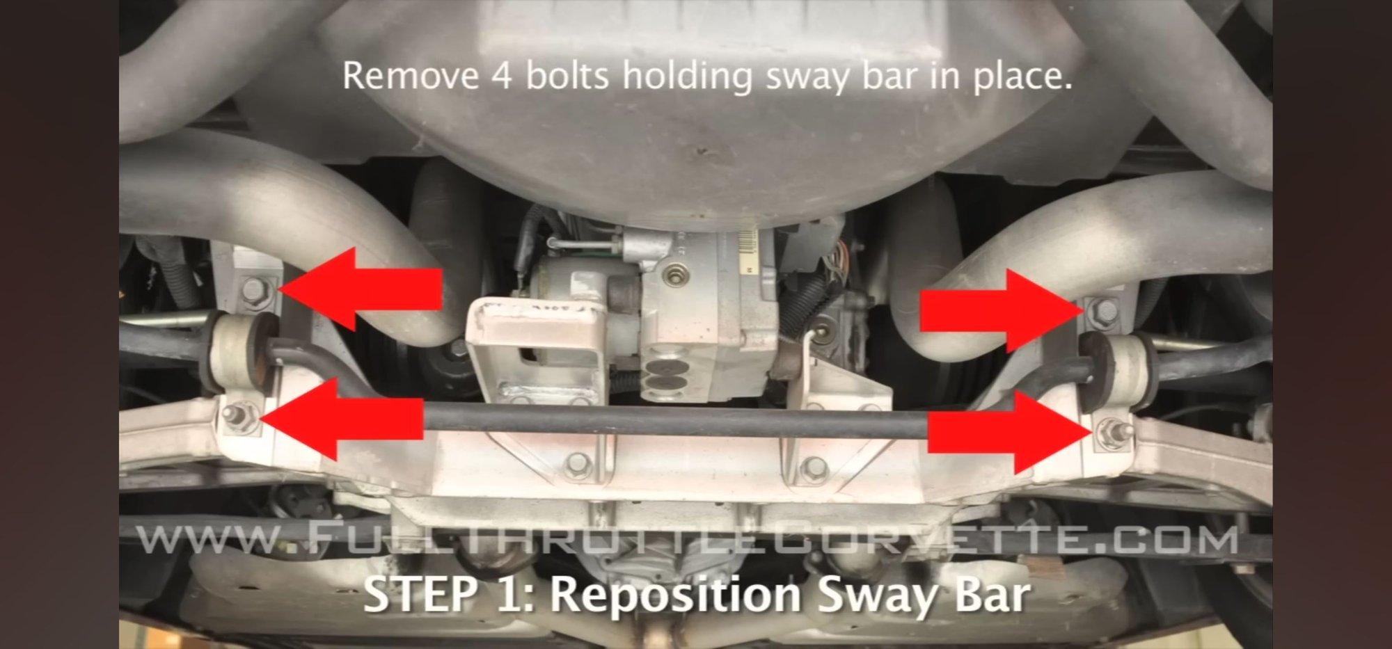

Also looking for torque spec for the flange bolts and the sway bar if anyone knows that thx

Heat is the best tool available to free up most any fastener. That and a good quality penetrating oil (NOT WD40!) like Kroil, PB Blaster, CRC, etc. If possible, try drilling a small hole down thru the center (keyword: CENTER, or as close to it as you can get it to center). Then try a couple of sizes larger drill bit. After youve soaked the broken piece for a couple days, try threading an easy-out into the broken bolt. Dont really twist it hard until youve put the torch onto the piece that the bolt is threaded into. Heat the Hell out of it. Then try twisting on the easy out. Be careful here, because if you break that easy-out off, you'll have an even larger problem. Hope this helps.....

Thanks however as mentioned earlier already soaked in penetrant. Also as mentioned earlier the angle and location of the bolt makes it impossible to get a drill in there.

Here's a list of torque values

Thank you - some clarification - I am assuming these are the values for the exhaust flange and the one rear hanger...

Can someone please clarify if these are the correct values for the sway bar bolts? Thank you

yes those are the right values for the sway bar if you torque them wrong you'll get noise. the upper part of the clamp is a bolt, the lower part is a nut, at the point where the sway bar attached to the cradle

You may have to remove the pipe to properly access or repair it. Heat.....No substitute for it. Penetrating oil, a GOOD penetrating oil (NOT WD-40), is only part of the solution. Heat is your biggest friend on removing broken bolts, especially exhaust bolts.....
