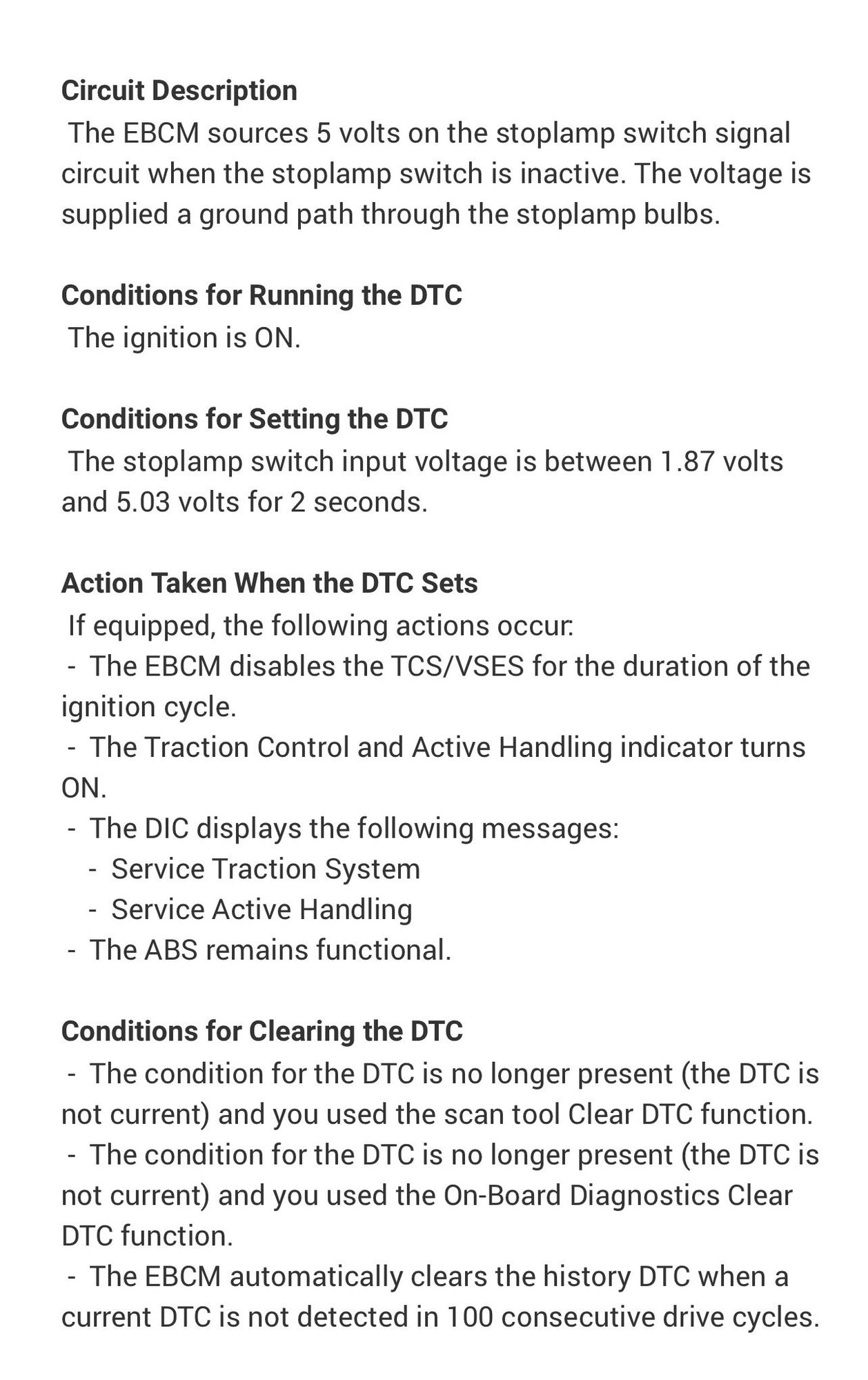

I was coming home today and I had just picked up my car from a body shop and I got a 'Service active Handling' and I parked it in the garage and I went out and checked the trouble codes and all I got was C1295-H and a B2860 which i know about but the C1295-H doesn't have anything to do with Active handling ? and how did it get a Historical marker ?

You have to read Service Info “Actions Taken When The DTC Sets”…in this case TC and AH messages illuminate…if the DTC is present and during the next ignition cycle if the DTC is present again it will move to “H” or History !!

Well that I understand, but why would I get a C1295 code, unless it has something to do with the Fact I switched to all LED's Front and back ? Everything works OK and I installed the Hyper-Flash harness which was a simple job, Only odd thing is now if I press the 4 way hazzard light button, I get the hyper-Flash but only if I'm using the 4 way flashers ?

Try replacing the brake lights with OEM bulbs. All kinds of very weird stuff can be caused by LEDs in the back.
