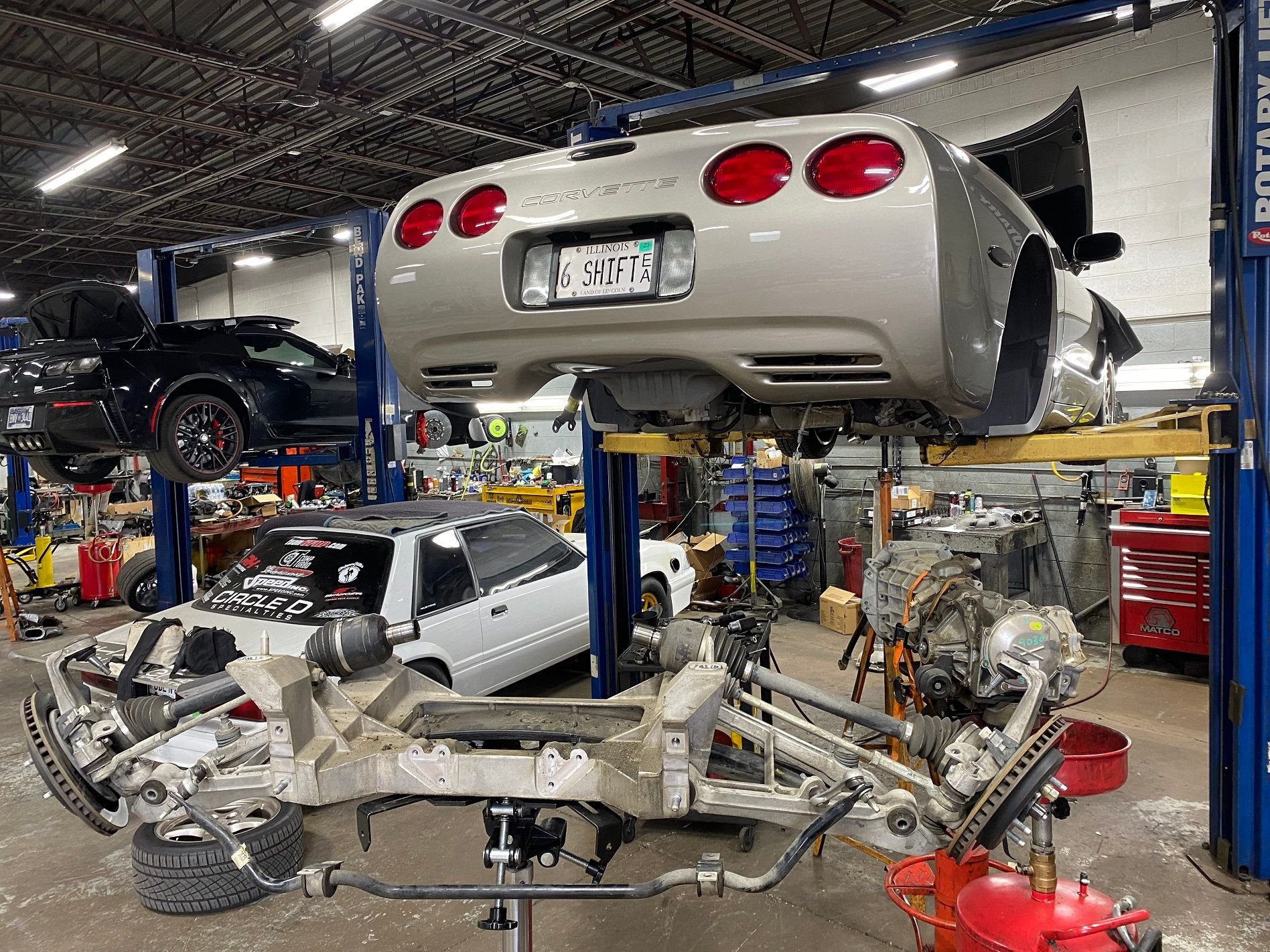

$800 isn't bad. There is nothing wrong with a McLeod Clutch. The RST is supposed to hold to 800hp and RXT to 1000hp. I've read good things about their single disc clutches as well. Which one do you have installed?
I just had my Clutch done with a newer Overhauled Torque Tube installed and the labor was $1600 here in the Chicago-land area. That was to replace or overhaul everything from the pilot bearing back to the differentiial. Its a big job to even get after that bearing. Cost of the GM bearing is around $22. I'd say he's doing you right by that $800 figure. Baffling why he wouldn't have quoted the bearing and anything else "While he was in there"...
Big job!

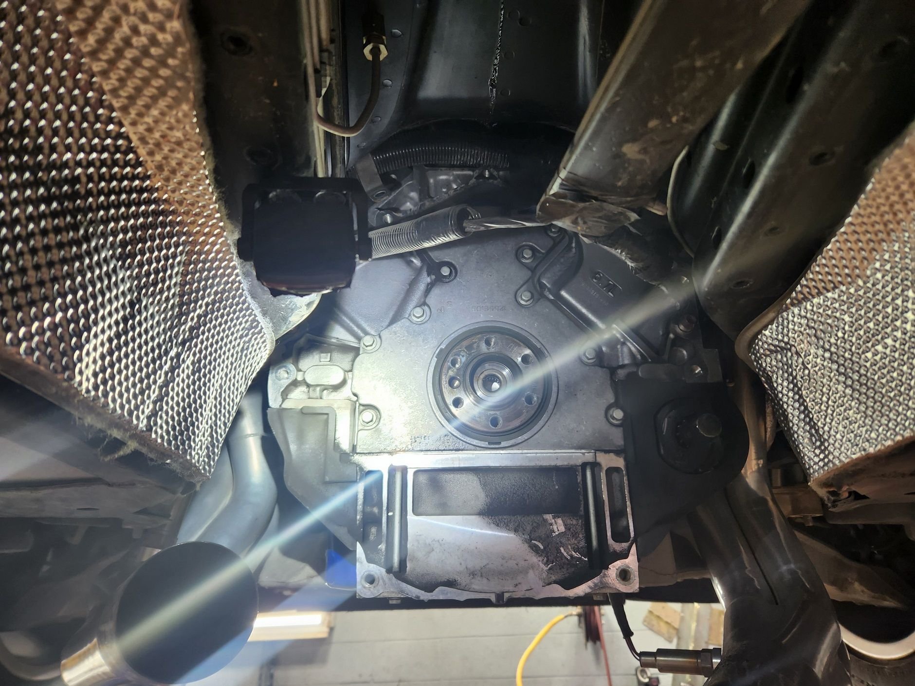

Lots of stuff to remove to get at the pilot bearing!
There she blows! Right in the center of the crankshaft.

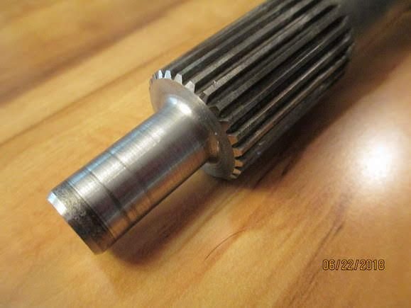

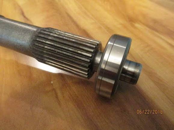

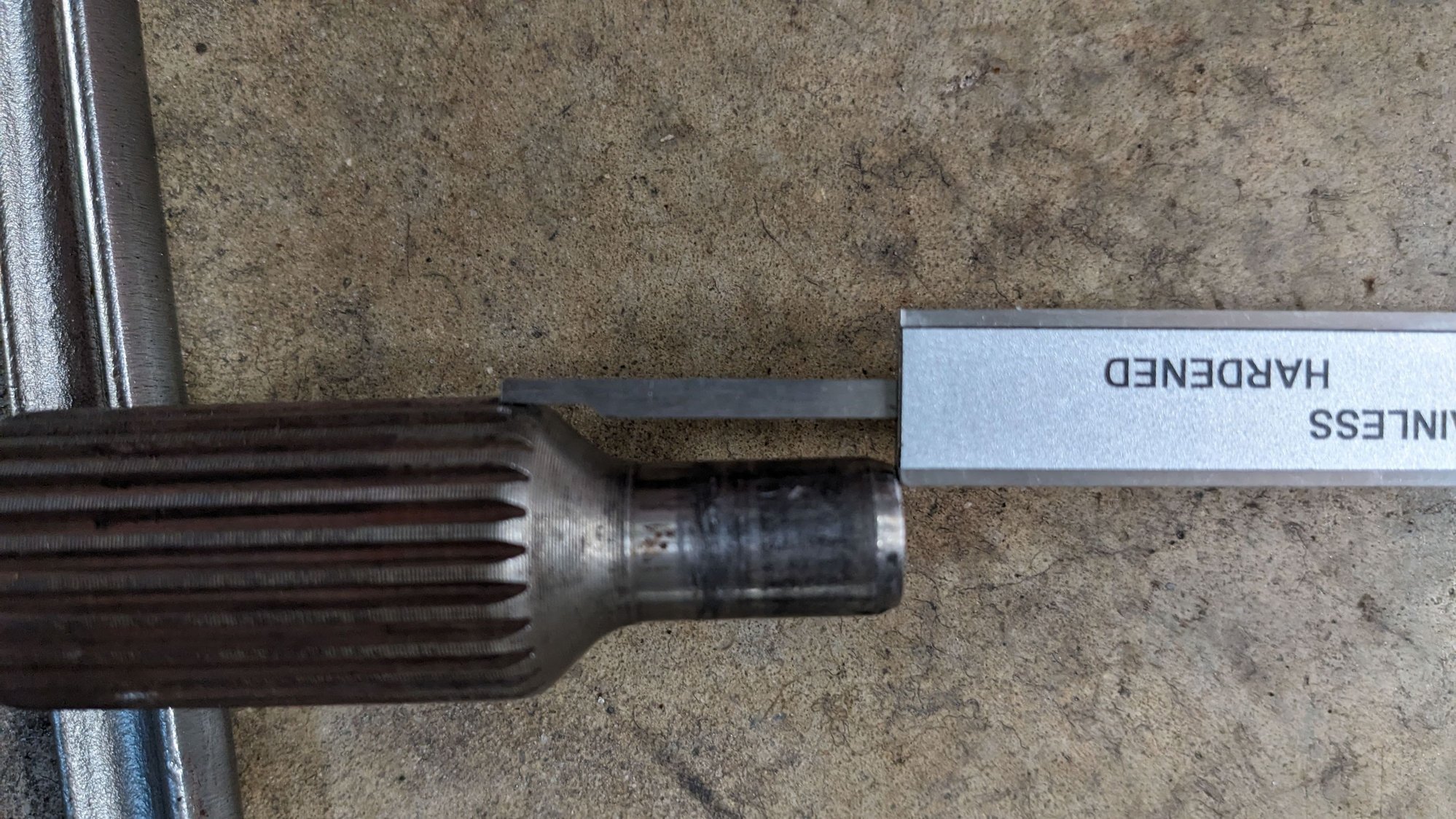

The thin needle bearing design is crap. No inner race so it gets all the clutch fist and when it grenades it eats the shaft.
Install Cadillac bearing and grind shaft to accommodate and give clearance.

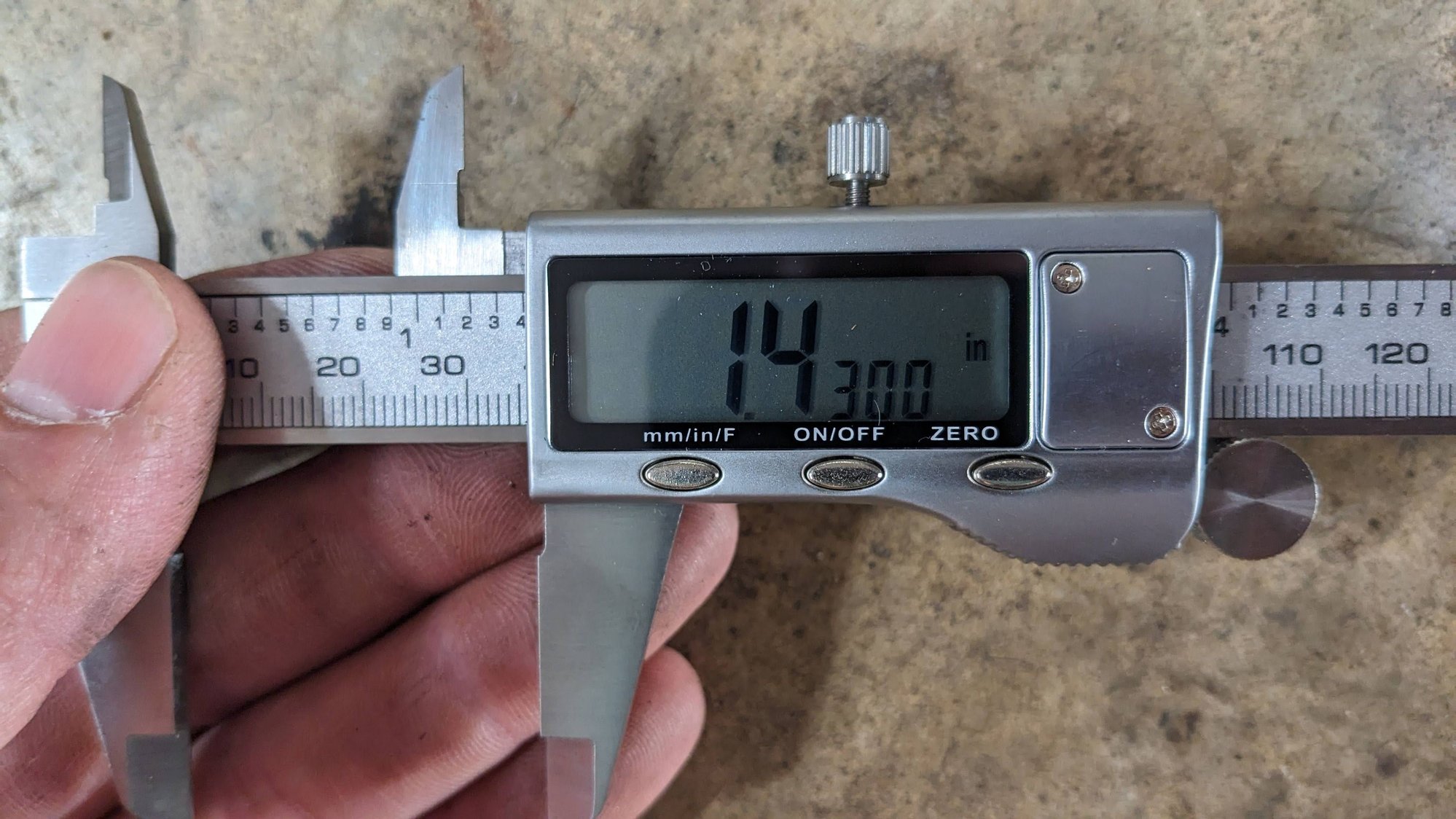

If I were doing the job myself I'd take the input shaft to work and do that mod. Looks like a much better solution. I was warned when the job was started that if the input shaft was bad that would be another $600 for a new one from GM. Your solution is a no brainier if you have access to a lathe (I do). If it ever comes apart again I will certainly do this. Thanks for posting. The shaft and bearing on mine were fine it was the older 1998 TT that cracked upon dis-assembly to go along with my smoked clutch from power upgrades I did this spring. I got an RPM overhauled TT from a newer car (2001-2004). With any luck I'll never have to have it down to that level again, but you never know...
Modifying the shaft would be easy, is there anything done to the ID of the crank? Got the PN/ application handy?

From tick performance I used this:
GM "Bigger" Pilot Bearing for LSx Applications
12557583 1 $21.99 USD $21.99 USD
This machine shop in Lakeland Florida did the grinding for me for $80: Terry Lesnett, machining Lakeland:
https://maps.app.goo.gl/fomrq23KczLcvTKX9
These are the guys in Texas that do it as well for the same price Texas drivetrain performance : https://maps.app.goo.gl/N26aggKDoKQctNLFA
Cheaper than putting the crappy pilot bearing with no inner race back in with a new shaft.
No alteration to the crankshaft needed. The crankshaft was designed to accept this bearing in Cadillac applications
When installing this upgraded bearing take note of the line since the bearing is directional. If you put it in backwards it won't slide in the crankshaft
