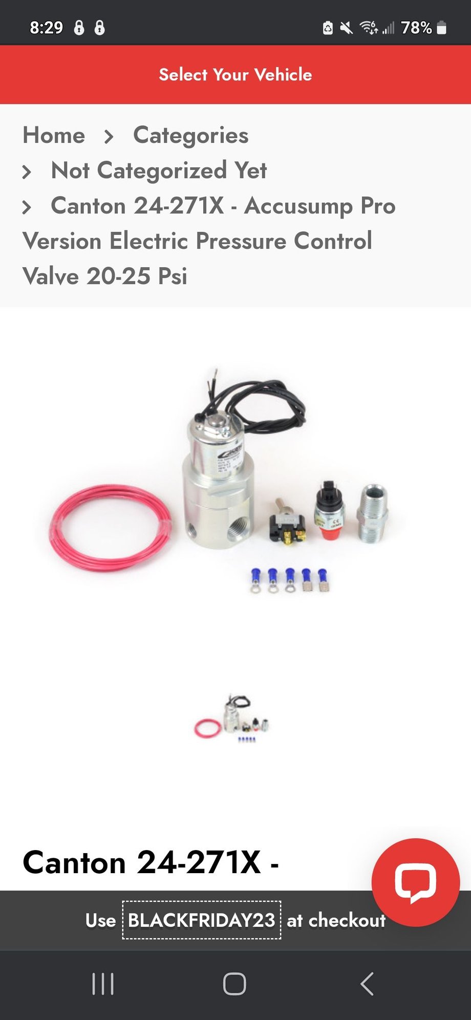

My accusump valve was sticking and not functioning properly. I bought a new valve kit but traced the problem to the little sensor (looks like an oil pressure switch). Maybe your valve is sticking and your engine is "hiding" oil in the accusump(?). Sounds like you've covered the mechanical basics. Yes, if guides or rings were bad you'd see it on the plugs.

Lol, don't think it could be hiding that many quarts! A few years ago it was sticking. Was able to disassemble and unstick the valve.
