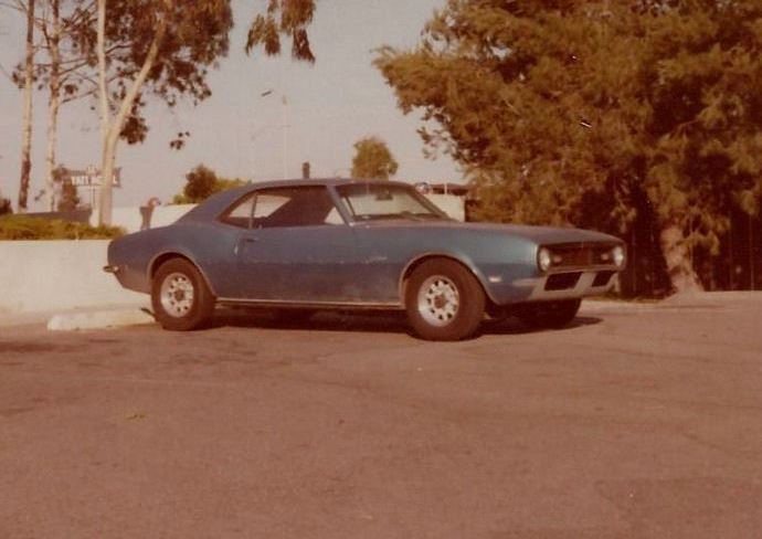

Around 1975 ish…. Not the cleanest ‘68 Camaro, but had a 427 and turbo 350 with a kit. Had a perfect interior, the body was solid, and I loved it.
I was painting boats back then, and aside from rent most of my money went into this car. As usual 😎

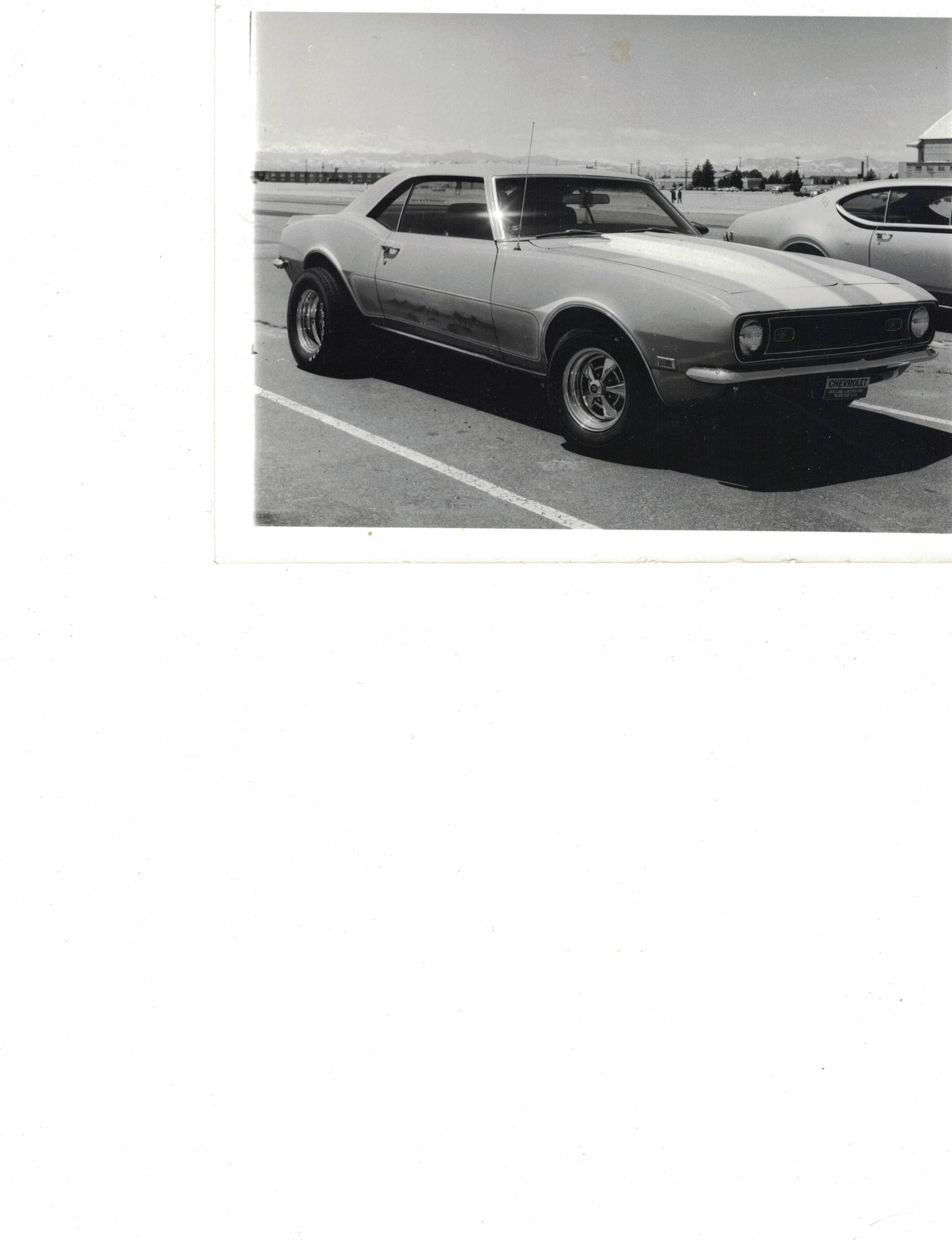

@vette4fl Nice ride Bill. Thos were some mean *** cars then (and now too). My first mod on her was adding a 671 on the 454 (not stock lol) and she pulled many a 10 second ride. n LA I ran around with Bill ***** and the LA Street Racers. Those were some fun times and this was before he got permission to open a strip in the Harbor area. Before the Harbor strip we would meet up in a Buena Park shopping center to pair up the street races and then go to the race place. This was behind the old Nabisco Factory in Buena Park. There was this 1 mile stretch of road behind Nabisco that was used primarily for shipping and receiving for Nabisco. There were RR spurs also toward the end of the half mile mark. The local LEO's would block off the road from the main entrance to Artesia Blvd so that regular folks would not enter by mistake and get hit by high speeding vehicles. Of course, truckers had priority, but we usually ran between 1am and daylight which was the low point of operations for truckers. The LEO's were volunteers off duty and some of them raced against us too!! What a blast because everybody wanted to race a cop car and get bragging right if you won. Good times for sure This is her when I was stationed at Lowry AFB in Colorado. My buddy's car next to mine was a 442 but I cannot remember for sure it's been so long ago, and memories tend to fade.

nice wheels on it. cragar?

Litttle late on this but yes sir, Cragar originals with the Blue caps. Later ones came out with red caps. Cheers!!!
