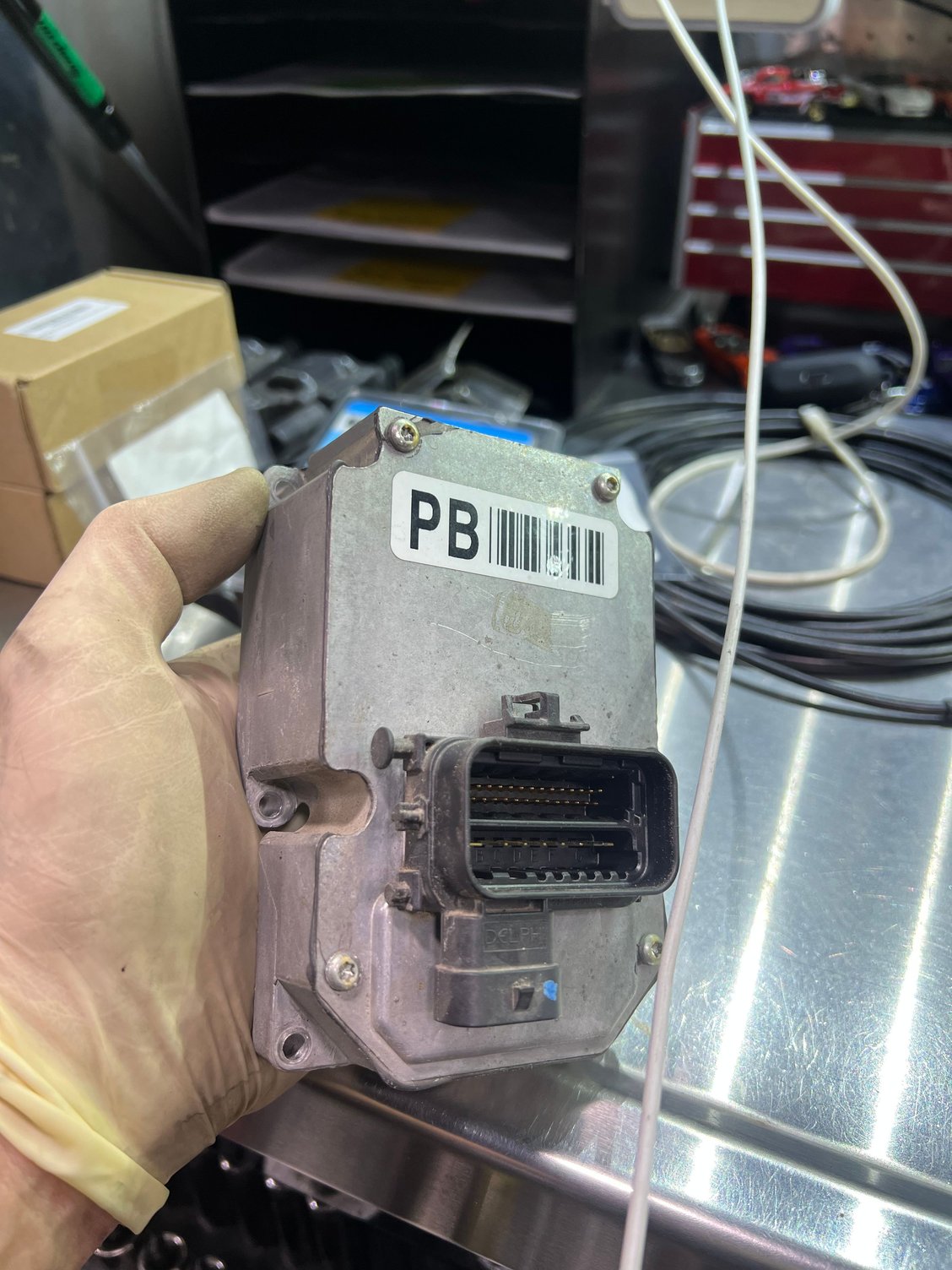

EBCM pulled today, going to ABSFixer tomorrow.

Part is fixed and on my way back to me:
”C1214 code in history. Repaired solenoid control circuit. Rebuilt pump control circuit. Tested power supply. Added surge suppression. Tested. Cleared code. All OK”

Thanks to ABSFixer and my local Chevy Dealership, I am back in business with no codes or issues!
