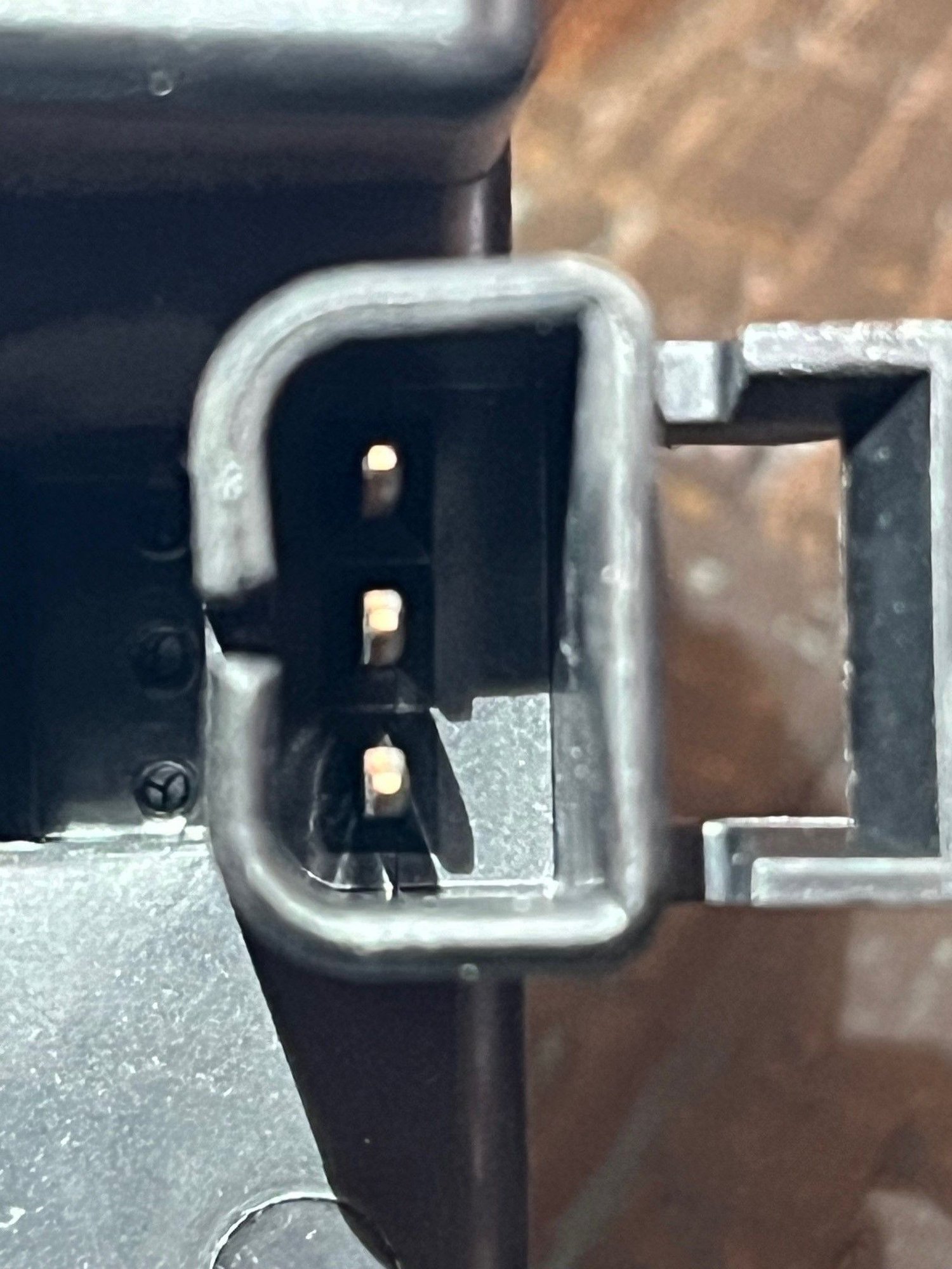

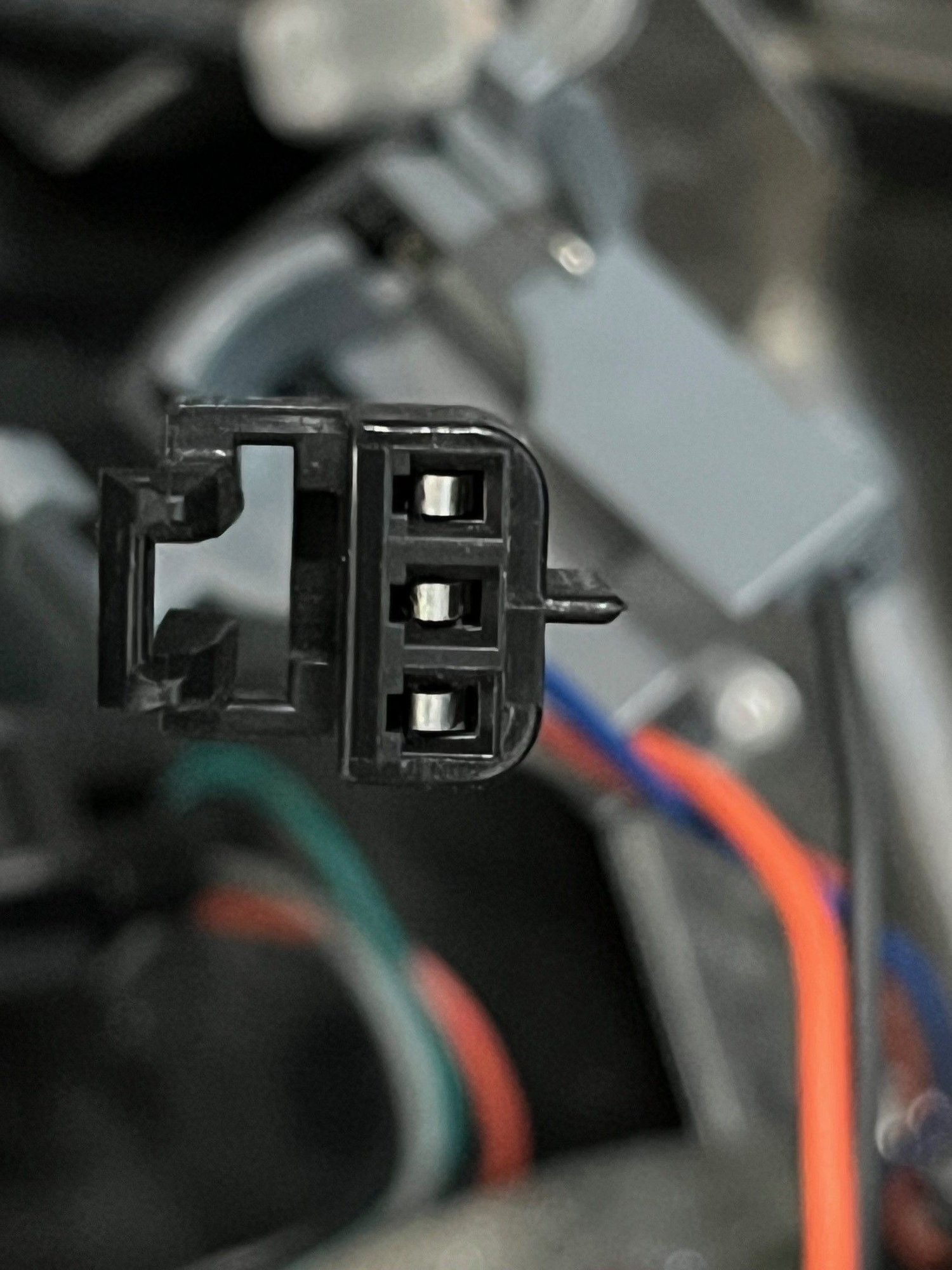

Hello. I am a new member here and have a 2004 Corvette Coupe (3rd owner) with 36K on the odometer. This last summer while driving down the highway at about 70 mph the front left tire locked up and I got the "service active handling" message. Checking the DIC the error code was C1282 H. I reset the code and went on about our day. Then it began to happen more and more often to the point where my wife refuses to drive the car and the factors have nearly always been different. Stopped at a stop light and the "service active handling" light comes on and throws the C1282 code. Driving and turning at 15 mph and the wheel locking up and throwing the error code again. It has been random enough that I feel it cannot be attributed to bumps, weather, or other driving conditions.
I pulled the sensor out this weekend and cleaned the contacts with electrical contact cleaner and a duster (no dust inside, very clean) and there were no signs of a poor connection such as loose wires or corrosion. Waited about an hour (battery disconnected) and then reinstalled it and went for a drive. While sitting at a stop light after about 7 miles, I was revving the engine the "service active handling" light came on again. So, I went home and pulled the sensor and took it my local mechanic who said there was really no good way to test the sensor and I may have to just buy a new one ($300-400 genuine GM).
I have read through the other threads and I had already installed a new batter last year (Optima red top) and while it did accidentally go dead last winter it is normally driven and ran as much as I can even through the winter when the roads are clear of all salt. Is there anything else that I can check without a high end multimeter? The grounds all look ok and I am not wanting to go down the path of replacing parts if I can avoid it. If anyone knows of a good corvette mechanic in the NE Indiana region, I'd be happy to give them a ring and see what we can figure out as well.

So I had my local mechanic (old GM/Pontiac dealer) order a new sensor (genuine GM) and installed it yesterday. Roads aren’t great here in NE Indiana but I’ve got about 15 miles on it so far without any issues. Hopefully this will be the fix.
