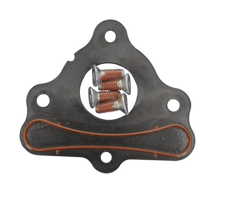

If the block is drilled and tapped for the dampener I used this one on my 98':
https://briantooleyracing.com/rde-ti...rde-62188.html
If you get a new cam retainer get four new tapered screws as the new plates have a chamfer for tapered retainer screws. The original ones on my 98 car where normal bolts with a completely flat plate/square mounting bolt holes.

I think you're talking about a countersunk hole and flat head screws. When building machinery, we were always told NOT to use Loctite on flat head screws. Reasoning was the large tapered area under the screw head held it from backing out. But I still used removable blue loctite(242?) on the retainer plate screws, training be damned!! Well, maybe I shouldn't have. My point is that when I needed to remove them for a cam change, they wouldn't budge!! IIRC, it was a Craftsman 5mm Allen bit I twisted off!!! This is a rare case where heating the fastener itself did the trick, as all you would need to do in that case would be to liquefy the Loctite. Sure enough, when the screw came out, blue Loctite was all over the tapered (countersunk) part of the hole......
Yup, Flat head screws/bolts. Different terminology. Original retainer bolt is a plain hex. Summit kit comes with flat head screw/bolt and they have "Patch lock" thread locker on the new screws and by design should only be used once. I had just bought a just a new style plate thinking I could reuse the bolts (with blue Loc-Tite) and the new plate had the countersink/chamfer, so when I had my car apart and had to wait for new flat head screw/ bolts.
Summit brand plate kit is sent with the flat screws (Should have just bought the kit):
https://www.summitracing.com/parts/sum-150106
Chain side has the countersink/chamfer. Engine side view of the plate.
There is really little force on this plate as a roller cam is ground with flat lobes, but since it seals the galleries going to the lifters... You could have a really bad day if these screws start to walk out. All about attention to details when you are performing engine work.

They discontinued the plain hex bolt retainer plate many years ago. FHCS (Flat Head Cap Screw is the correct terminology) retainer plate has been used since around 2007(?). Be careful torquing the FHCS's to recommended torque-Some well known engine builders, Kurt Urban being one of them, have told me the plates can crack when torqued to the correct value(18lb/ft?).
